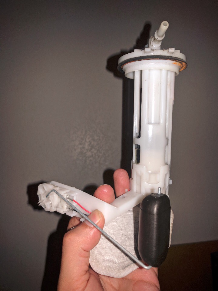

Here is the used fuel pump, might need slight cleaning. Just waiting for the fuel tank now. I got the fuel pump from ebay for $34.99 shipped.

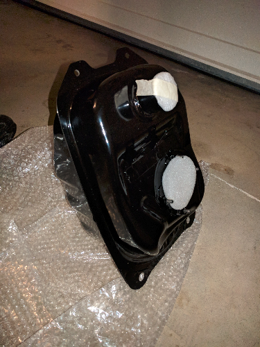

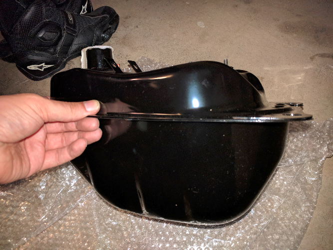

I got my tank 8) and new air filter. I think the air filter was the original one. Now some pictures.

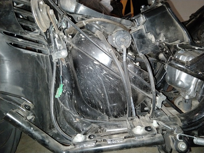

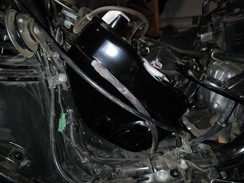

Jurry is out:
AND
NO
PCX150Rider
Posts: 1832
Location: Old Saybrook, CT
Re: My attempt to retrofit the bigger OEM fuel tank into 201
Post by PCX150Rider »
Looks like it's just too big. . .the fuel lid won't fit either? :o
Forget about putting the panels back on. It looks like there is no way that they will fit.

Fuel tank:
The 2 gal fuel tank is wider, and a bit longer. The top two bolt holes on the tank do light up, the issue seems to be the bottom two bolt holes. They are farther apart and mount further down into the frame. With some cutting and welding it might bolt onto the scoot, but because it's wider it won't fit between the plastic panels. I'm not going to do all that to fit it in, I might look into an auxiliary tank, or just live with the stock tank's fuel capacity. At least the idea of the 2 gallon tank is settled, LOL. I tried. :)
