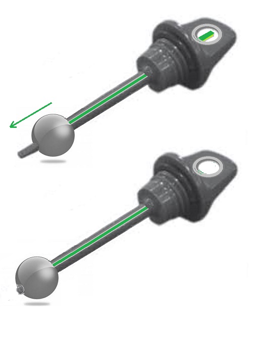

The above April fools day gag inflatable dipstick has be thinking there is something more here to draft.
What if one was to design something like this for all bikes? Tell me if you boys and girls get this
A float drives an indicator into a window on the grasp... would you buy this if it worked?

Dipsticks are so dumb, clearly there's a better solution.
- PCX150Rider
- Posts: 1832
- Location: Old Saybrook, CT
Re: dip sticks...
The crankcase "sight glasses" are really the way to go on motorcycles and scooters IMHO. It not only allows one to note the oil level but also examine the general appearance of the oil to see if it's looking ugly or is getting any water contamination (streaks of light color) from too many brief startups or not allowing the engine to run long enough to get up to operating temperature and let evaporation do it's thing.Dipsticks are so dumb, clearly there's a better solution.

Look what Harley has. . . https://houseofharley.com/harley-davids ... 5-09A.htmlThe above April fools day gag inflatable dipstick has be thinking there is something more here to draft.
What if one was to design something like this for all bikes? Tell me if you boys and girls get this![]()

I like that eye portal GN! It does make you wonder why we have dip sticks at all. Perhaps since they have to drill an oil fill hole anyway a second one for an eye would put the bike out of my price range

That concept reminds me of a fuel oil level gauge for a 275 gallon tank. It would probably work as long as the flotation device would drive the indicator bar vertically with no hang ups.A float drives an indicator into a window on the grasp... would you buy this if it worked?
At $14.95 it would probably sell with a ton of reviews and 4 out of 5 stars.
It seems like a more fail-safe gadget than an electric readout product. And if it sticks you can always try putting the PCX up and down on the center stand a few times to jog it loose.

I think a couple things would aid in fail safe operation... engine vibration and the fact its saturated in oilPCX150Rider wrote:It would probably work as long as the flotation device would drive the indicator bar vertically with no hang ups. At $14.95 it would probably sell with a ton of reviews and 4 out of 5 stars.It seems like a more fail-safe gadget than an electric readout product. And if it sticks you can always try putting the PCX up and down on the center stand a few times to jog it loose.

If it's a "top read" gauge then a spiral type contraption that would rotate as the float rises or sinks would be required. I think I've seen lawn mowers that have this type of gauge in gas tanks.It needs to connect to the push rod and must be made of a buoyant material that does not degrade from heat or petroleum. If hollow be sealed around the core and still make the connection to the rod. If solid still be buoyant. I can't yet see the float design in my minds eye.
If it's a "side read" or "section view" gauge then it could just be a float that's hard mounted to the indicator bar or rod in the appropriate location.
Two challenges either way are going to be keeping the gauge mechanically sealed and eliminating any interference in the range of movement.
