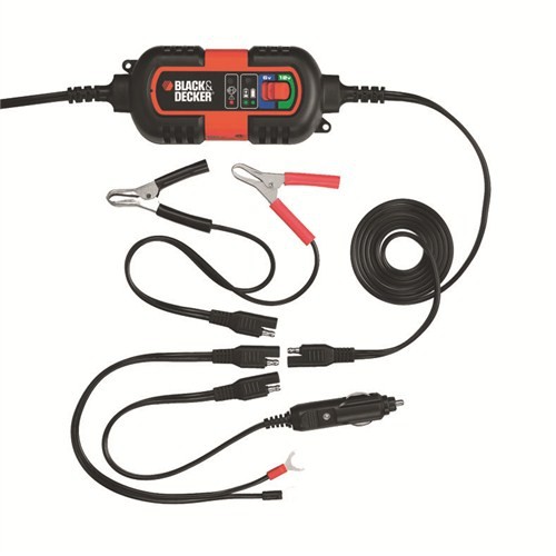

sometimes i don't ride my motorcycle like 2 or 3 weeks , sometimes weather is getting really cold here -20C / -4F . too cold is not good for batteries i know that, i have battery charger and it has option for 12v socket charger. but i don't wanna keep open seat for charge connection into the battery all night, my question is ;
can i charge my battery from 12v socket directly ? does anyone tried that before? my charger is 1 amp max capacity and pcx charge socket supports 1 amp too..my charger is Black&Decker BDV090.everything looks fine but i want to be sure about it before use.

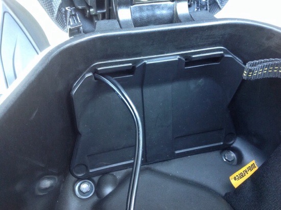

So long as the socket has power with the ignition off, you should be fine. If the fuse is good for 1 amp going out, it should be fine for one amp going in. Bear in mind that I am not an electrical engineer, so I might be totally off the wall.
As a test, plug something into the 12V outlet and see if it is hot with the ignition off. If it isn't, you could use the quick connect battery terminal lead in your picture and just have it run out under your seat for cold weather recharge. I don't think the seat gasket would get too upset.

thank you GeorsSK..i have usb mobile charger, it has a light on it when it's active. let me try it, if it starts to charge my phone when igniton off , i will not use battery terminal overthere..if it's not i will use my charger overhere..thank you again for your advice and timeGeorgeSK wrote:So long as the socket has power with the ignition off, you should be fine. If the fuse is good for 1 amp going out, it should be fine for one amp going in. Bear in mind that I am not an electrical engineer, so I might be totally off the wall.

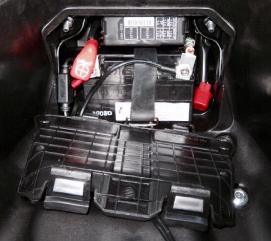

Re: 12v socket (cigarette lighter charge)
I believe that the 12v outlet is deactivated when the ignition is turned to off.
There should be a hole in the seat hinge that will allow you to pass the external power leads directly from the battery to outside of the storage compartment. That way, you can connect the charger by way of that cable whenever you wish to charge the battery. You can also attach other devices to that lead as necessary when riding (such as a USB outlet), and it will give you a direct connection to the battery.
https://www.amazon.com/Battery-Tender-0 ... 15&sr=8-15
The accessory port is only on when the scooter is on. For me the answer was to add a quick connect to the battery, which I use to power the alarm, tire inflator (with scooter running) and a battery charger should the need arise.

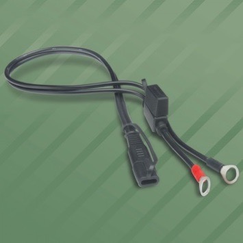

If you put one of these on your battery you won't have any problem charging the battery or connecting accessories.
https://www.amazon.com/Tetra-Teknica-Mo ... 3C0A3YZSVR

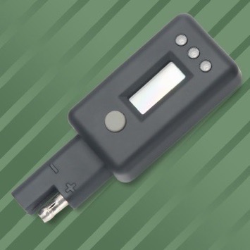

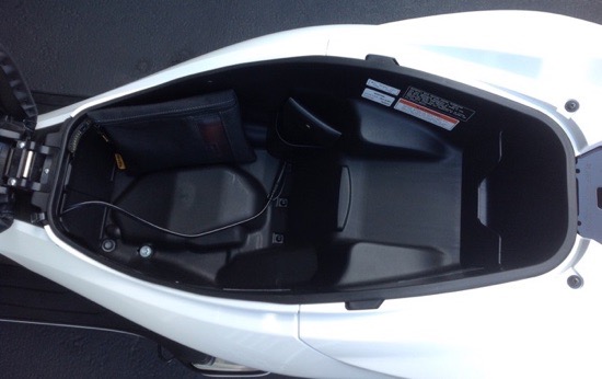

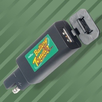

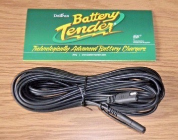

"Beam me up, Scotty" or is it, "Scotty, beam me up?"
Anywho, sharing some pics of Battery Tender, accessory leads, etc
Simples
Simples
- image.jpeg (101.6 KiB) Viewed 7507 times
- image.jpeg (47.59 KiB) Viewed 7507 times
- image.jpeg (24.75 KiB) Viewed 7507 times
- image.jpeg (29.58 KiB) Viewed 7507 times
- image.jpeg (37.49 KiB) Viewed 7507 times
- image.jpeg (29.91 KiB) Viewed 7507 times
- image.jpeg (84.58 KiB) Viewed 7507 times
- image.jpeg (48.73 KiB) Viewed 7507 times
- image.jpeg (71.23 KiB) Viewed 7507 times

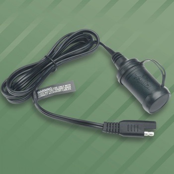

Somewhere among my misc junk I have a 12 volt accessory receptacle that plugs into the battery accessory cable that comes with the Battery Tender that I bought. I eventually shelved it because I mostly used it as a usb port, but I found one of those and no longer needed the receptacle. Determine what you would use the outlet for and I bet you could find a connector that would have it on it already.
