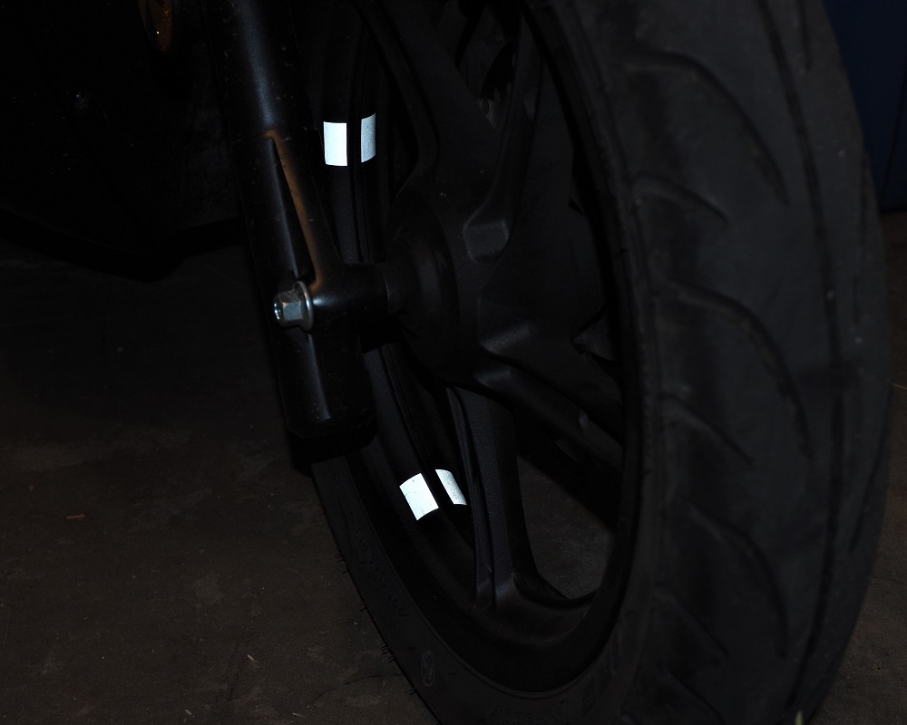

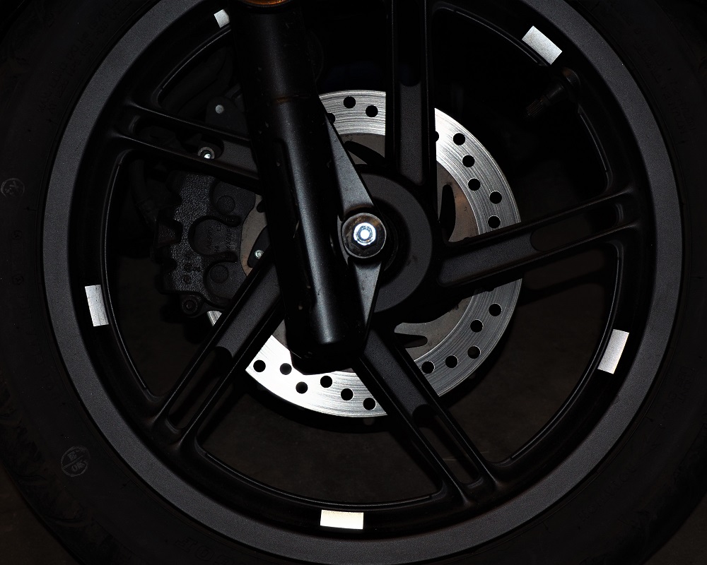

What I did on my wheels was place strips of reflective tape across the rims rather than around the rims. That way they're visible both from the sides and from the front/rear. The front rim has a center rib that I didn't tape over, but the rear doesn't and the tape goes across from one side to the other.
Side view of front wheel
3/4 view of front wheel
I tried to create a short video clip of the wheel spinning, but got frustrated with the free video editors and gave up. :roll:
Here's a video clip of a similar effect on a bicycle wheel:
(skip to about 00:33)
Reflective tape on bicycle wheels
I didn't use as many strips, so the effect has more "motion" on my wheels.
