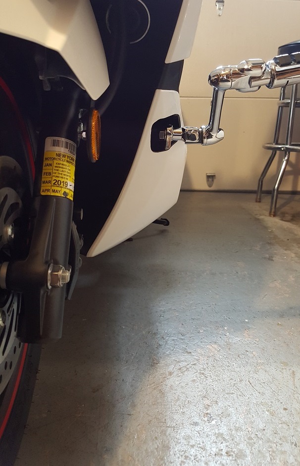

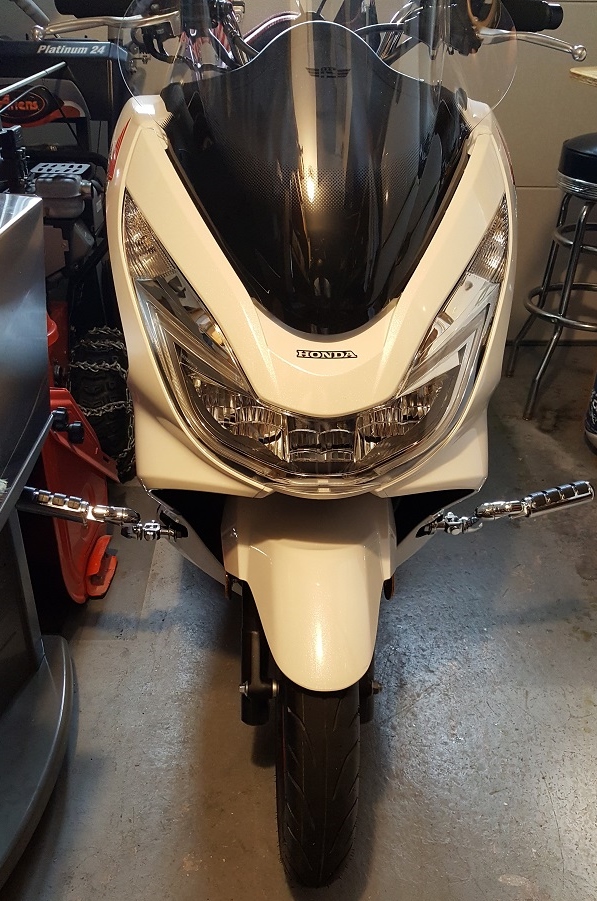

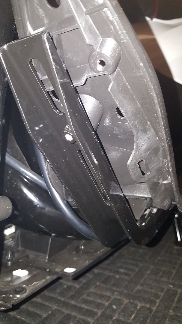

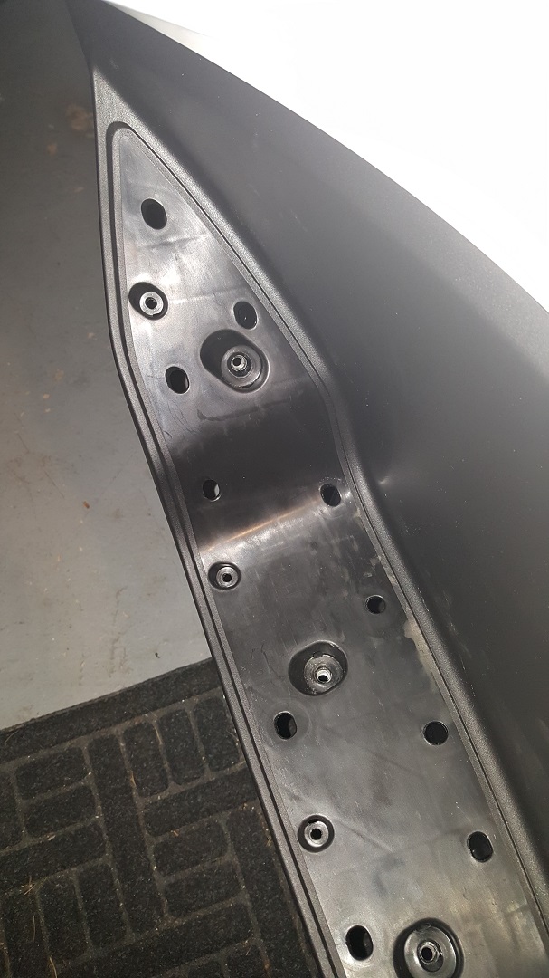

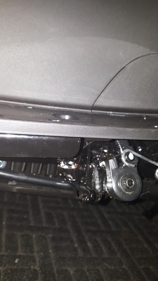

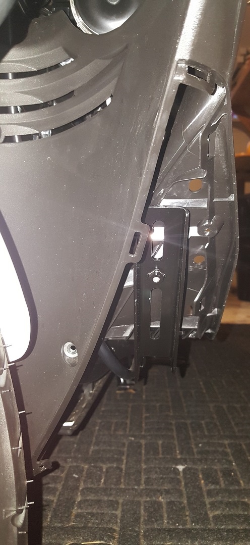

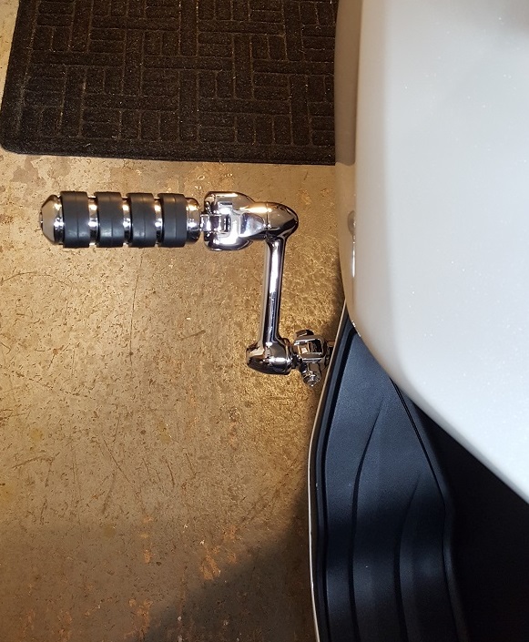

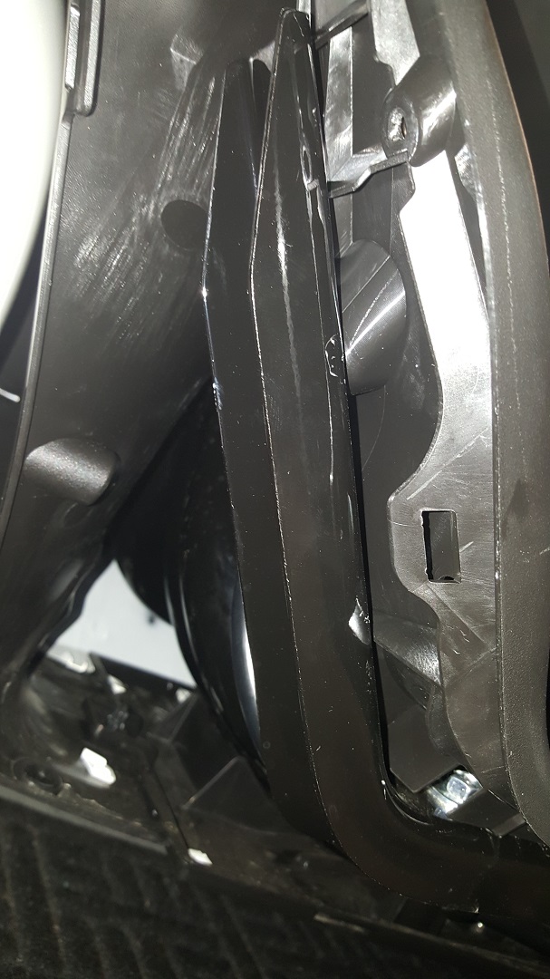

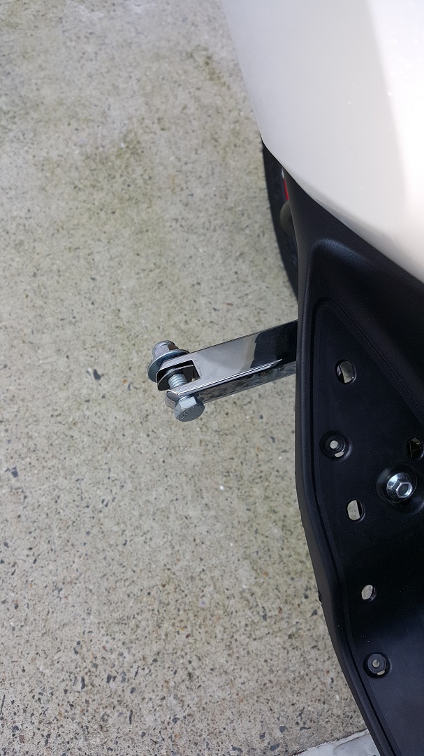

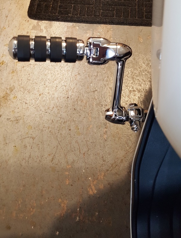

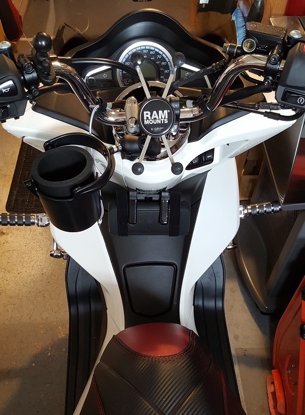

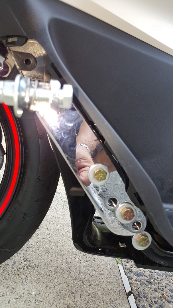

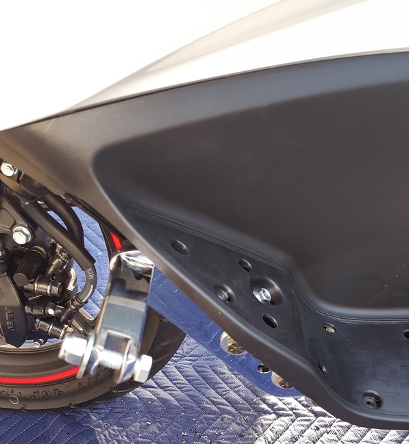

I'm going to attempt uploading some pics to show exactly what I've done and how I did it if anyone is interested in doing this mod.
Being 6'2" I couldn't even ride my bike for any extended period of time before getting cramped up. Now my legs are basically straight with a slight bend at the knees and I have a full range of further adjustments if I need to.
The pics are basically self-explanatory and I cover every step. Cutting the plastics was the most difficult part of the entire job since the measurements have to be precise and....if you use the Wrong tool you will break/crack the plastic...Like I did! (So I ordered 2 new ones and was extra careful).
I used a Dremel with a multi-purpose cutting bit and followed my outline Very slowly. After a little sanding I'm very happy with how they turned out.
PS: DO NOT use a jig saw to cut the plastics, the vibration is what destroyed them!

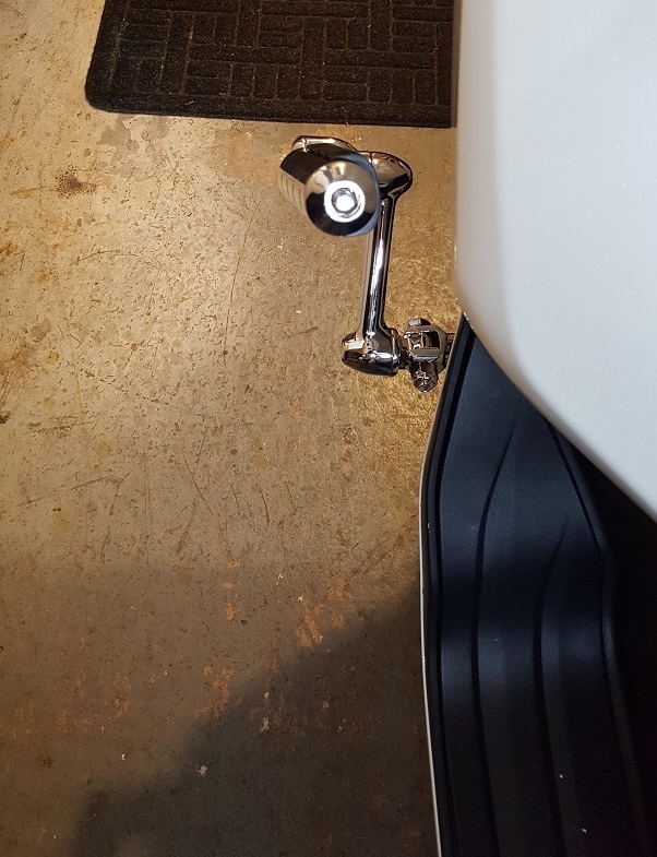

- These final set of pics show the finished product with the adjustable Kuryaken 4 inch multi-adjustable peg mounts and pegs I chose.
- 20180918_100808.jpg (370.88 KiB) Viewed 16904 times

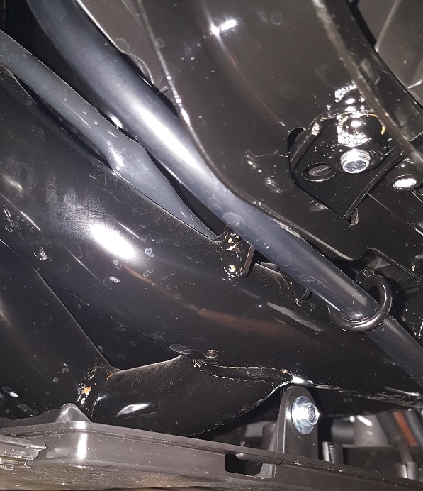

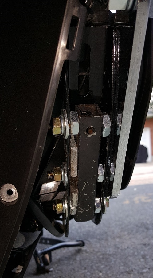

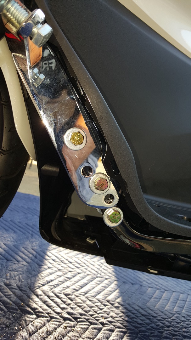

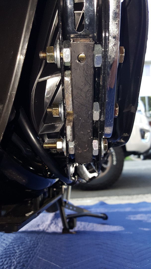

- The next few pics show where I drilled, how I bolted everything together and how the spacers were used.
- 20180815_181706_001.jpg (182.84 KiB) Viewed 16904 times

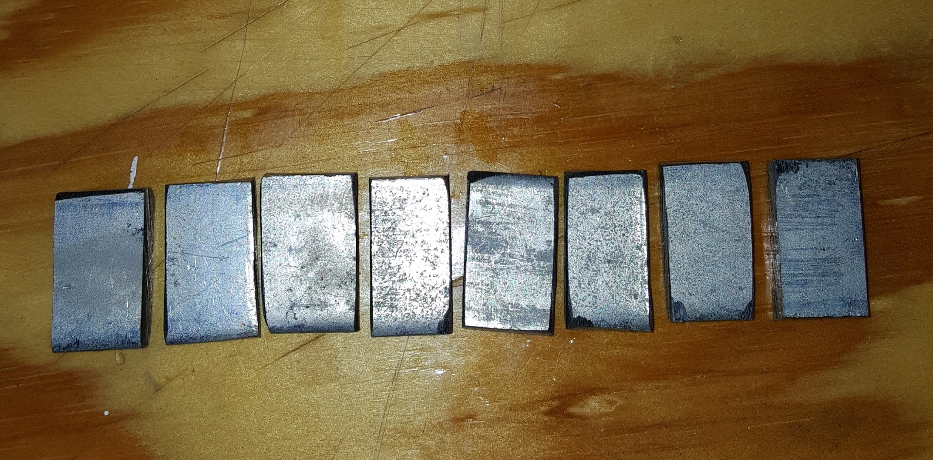

- Since the U-Channel is 1 1/4" wide I had to cut 1/4" thick coins to act as spacers to fill the void on both sides inside the channel, again, so it wouldn't squeeze together under torque load when tightening. If 1 1/4" square stock was available I would have preferred to use that.
- 20180811_120435.jpg (836.7 KiB) Viewed 16904 times

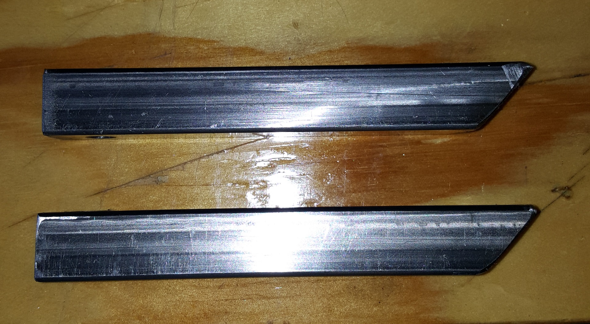

- I cut the ends on this angle so the would taper to match the bottom edge of the support.
- 20180811_120341.jpg (759.21 KiB) Viewed 16904 times

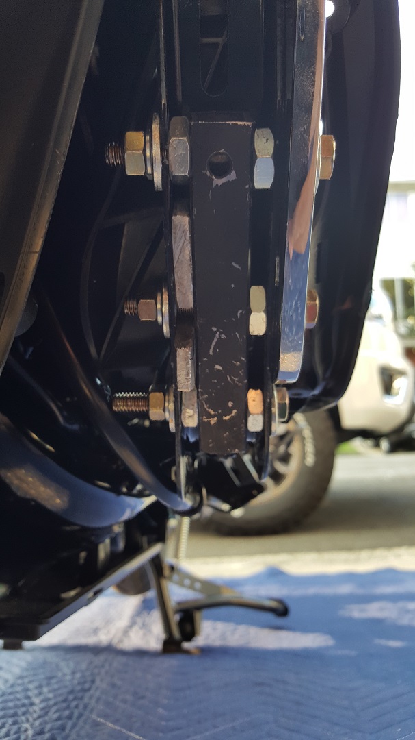

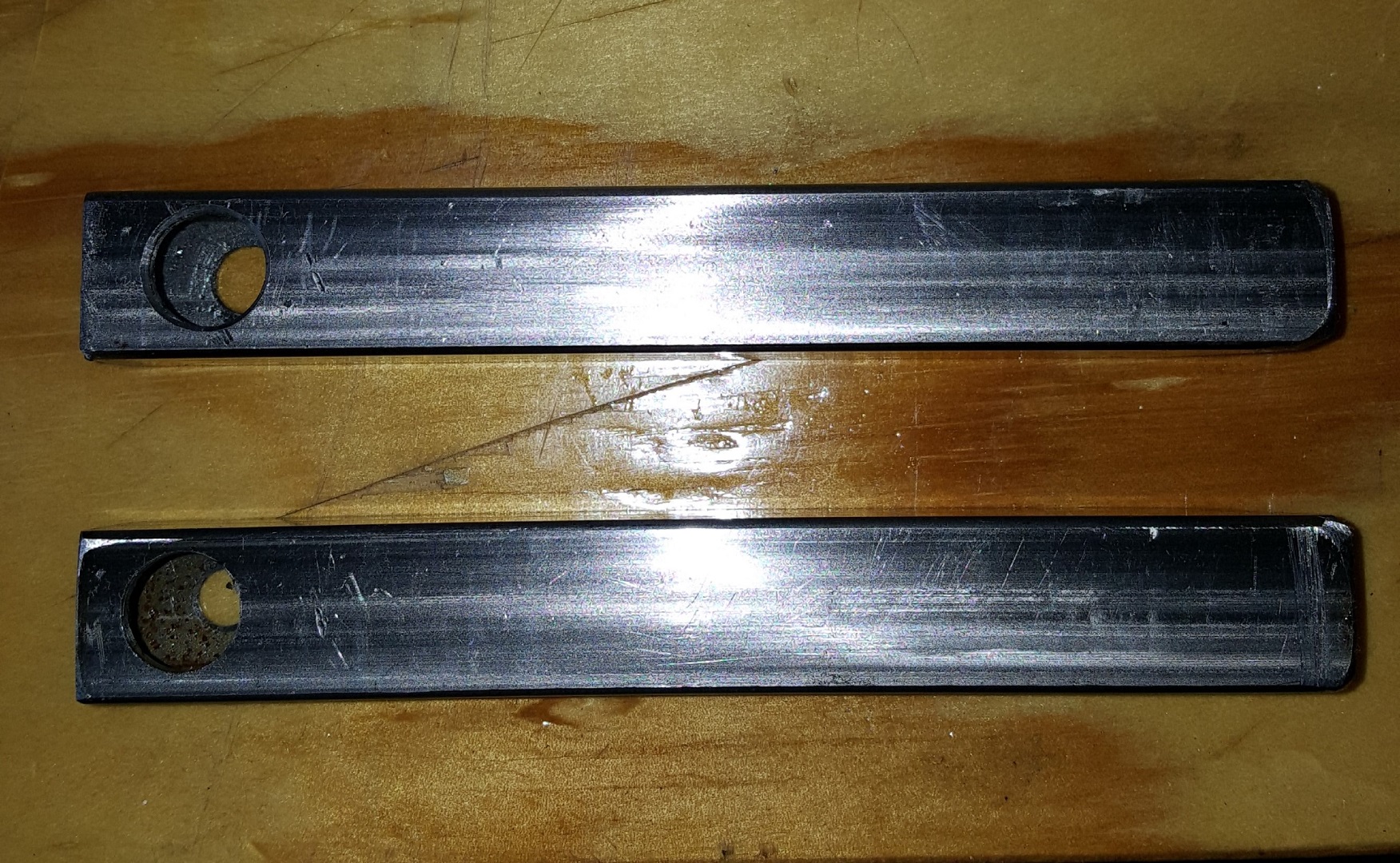

- Here are the 2 reinforcement pieces I cut and had to drills a 5/16 hole to clear the welded nut inside the channel so it sat flush.
- 20180811_120310.jpg (797.2 KiB) Viewed 16904 times
- Since the support is basically a U-channel I needed to reinforce it so when I torqued down on the attaching bolts I wouldn't collapse the sides. For this I used 3/4" square stock from Home Depot, sidewalls are 1/16" thick and it's very strong.
- 20180811_120414.jpg (181.11 KiB) Viewed 16904 times
- 20180731_200541.jpg (207.29 KiB) Viewed 16904 times
- 20180731_200924.jpg (186.98 KiB) Viewed 16904 times
- 20180731_200912.jpg (182.28 KiB) Viewed 16904 times
- 20180731_200857.jpg (212.79 KiB) Viewed 16904 times
- 20180731_200402.jpg (258.76 KiB) Viewed 16904 times
- 20180731_200233.jpg (224.46 KiB) Viewed 16904 times
- These next pics show basically how the floorboard support runs all the way back to the center of the bike on each side.
- 20180731_200157.jpg (267.93 KiB) Viewed 16904 times

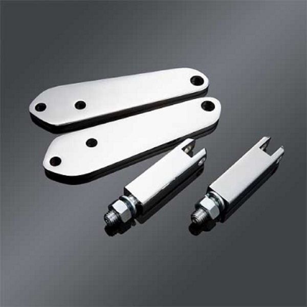

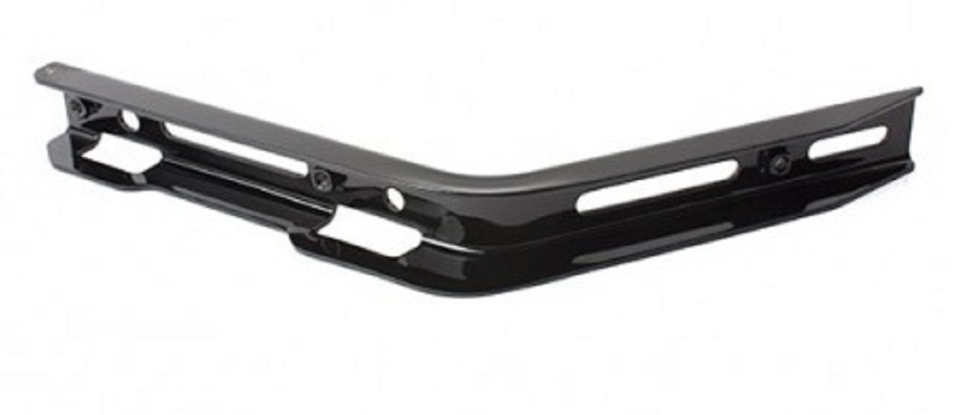

- These are the brackets I used. They're highway peg brackets and pegs made for an older HD Dyna. there are quarter inch thick hardened steel and I only use these pegs temporarily for measurements.
- HD Dyna Highway Peg Mounts_New.jpg (50.09 KiB) Viewed 16904 times
- s-l1600 (3).jpg (319.8 KiB) Viewed 16904 times

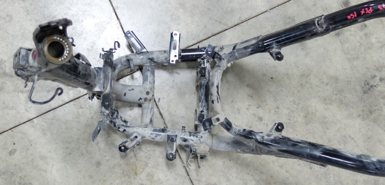

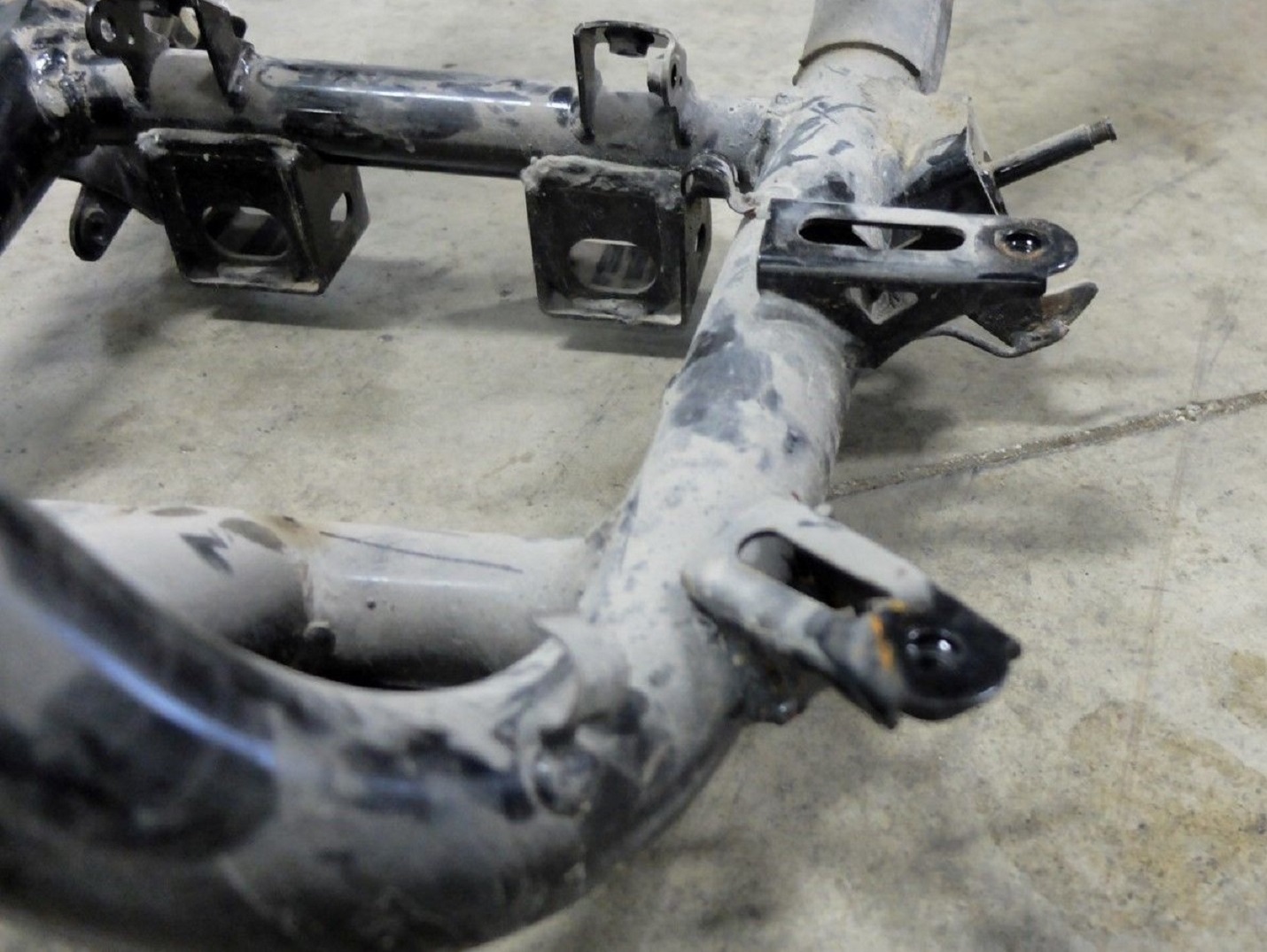

- These next pics show what the frame looks like and where the floorboard support attaches to.
- s-l1600.jpg (365.57 KiB) Viewed 16904 times
- This is what I mounted my brackets to, which supports the floorboard which is bolted to the frame.
- stay-right-floor-honda-pcx-125150-v3-2014-2015-2016-2017-50621-k35-v00.jpg (46.84 KiB) Viewed 16904 times

Also, I forgot to mention....If any of you decide to do this you have to Make Sure that the brackets bolted to the U-channel don't come down any lower than the bottom edge of the U-channel or the plastics Won't clear when reinstalling. Ask me how I know this! Yup, just when I thought I was done I had to go back and use a cutoff wheel to cut about 3/8" of the bracket off the bottom.
ALSO, if any of you have access to a welder it would make this job a hell of a lot easier and quicker!

Sorry about the photos being in Reverse order. Just read my post and realized that, so I had to read it from bottom to top, LOL.

Wow. You must have REALLY wanted the mod - what a lot of work. I admire your courage to modify your new machine. The job came out great!
