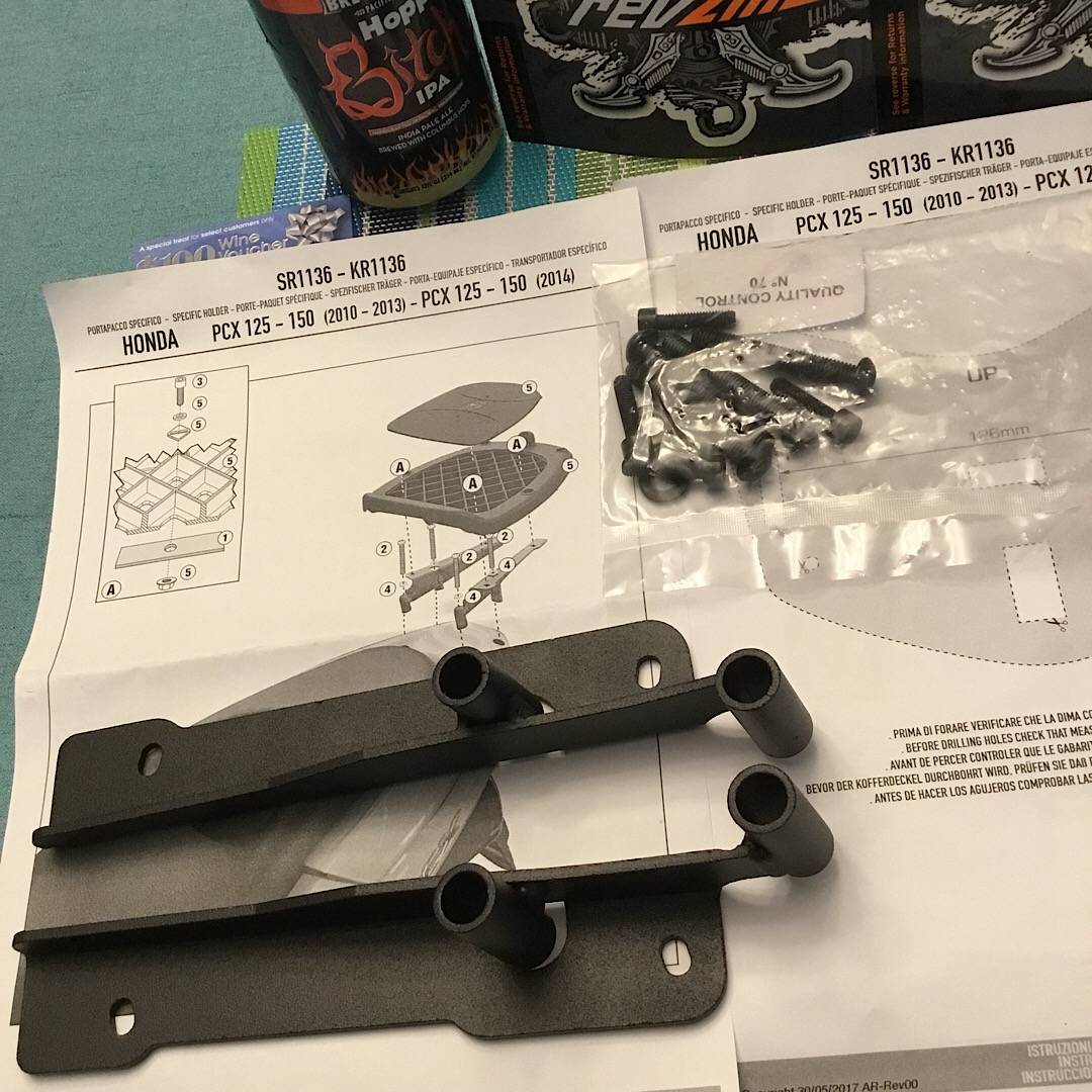

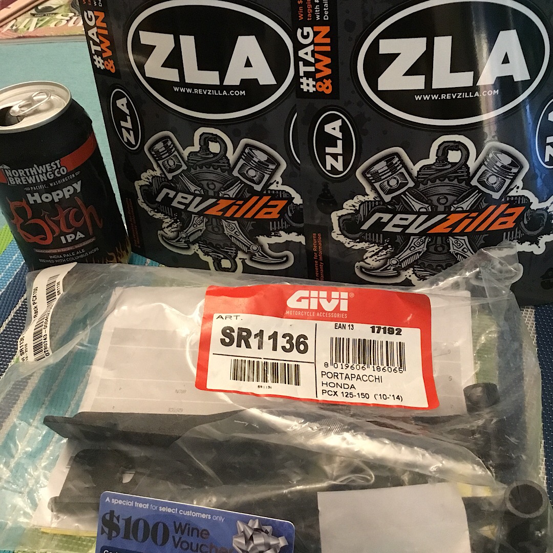

Hi, just got this today. On Givi and Revzilla’s site, their description on Givi’s topcase rack is: “SR1136 Monolock Specific Rack”. So since I already have a 40L Monokey topcase on my elite, I was discouraged about looking any further into this rack. Long story short (after emailing Givi and just looking at the pics of it) it’ll work with the E251 Adapter Plate Universal (I already bought separately for the 40L Monokey topcase) for the Honda PCX. The only difference is that 2011-2013 you need to drill through the rear plastic panel. The 2015-2018 you can choose to drill it or just remove the panel.

I’ll install it in a few days, hopefully it’ll fit w/o any problems. I probably will just remove my panel and not drill it.
Re: New Givi Topcase Rack
It should fit without any problems. Other members have just popped the cover off and installed it. Just be careful not to cross-thread those bolts. Hand tighten as far as you can before using the tool to finish.

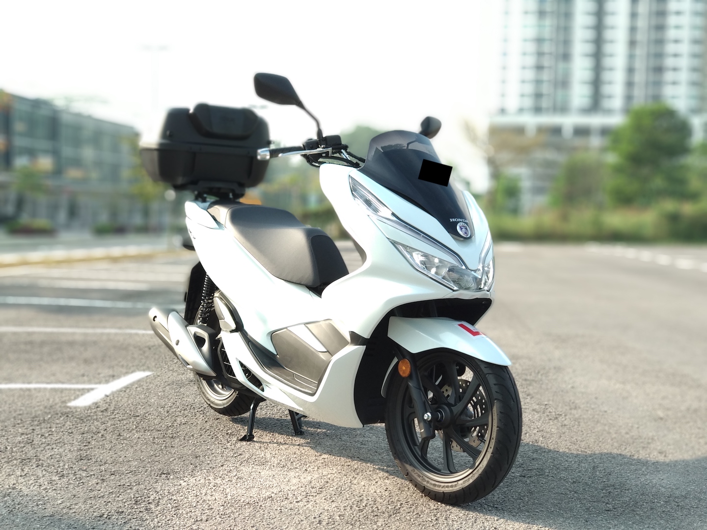

Hi
I installed the same rack as pictured, and also bought a 43 litre Givi E43NTL-ADV box, which comes standard with a back-rest and some other accessories.
I attached some photos.

- PCX with rack and E43NTL-ADV
- PCX with Givi front.jpg (578.68 KiB) Viewed 1543 times

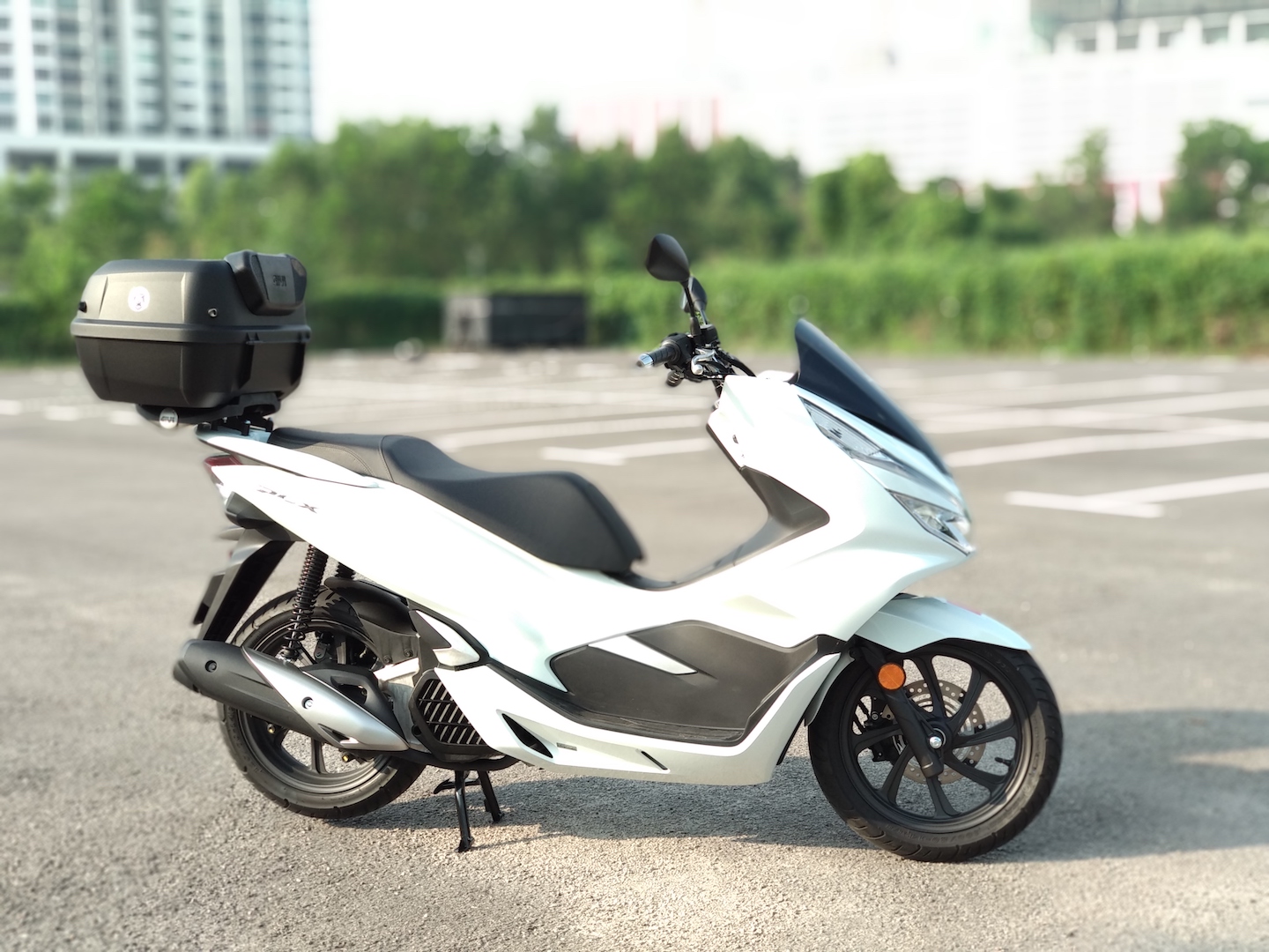

- PCX with Givi side.jpg (541.58 KiB) Viewed 1543 times

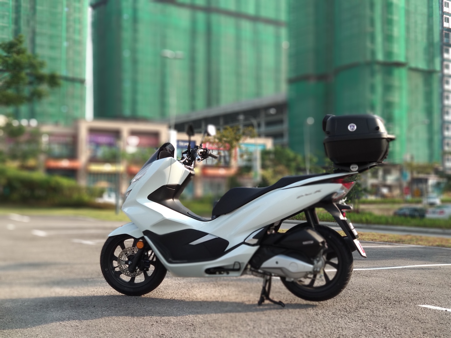

- PCX with rack and E43NTL-ADV another side view
- PCX with Givi side2.jpg (516.24 KiB) Viewed 1543 times
