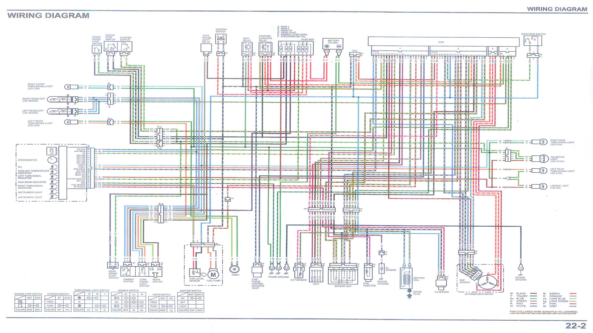

Is there a cut off switch that shuts the motor off if the bike is in a crash or goes down? But I agree with above that you should check every cut off circuit,like kick stand,cut off switch, and / if there is an accident fuel cut off sensor/ switch.One of those switches could be the culprit..
Re: PCX 150 engine suddenly stalls and will not turn over.
In case you don't have one, here is a wiring diagram for a 2013 model, which should be the same as a 2011 model. Maybe you can check everything that has a cutoff switch before looking into the more serious items.
Also, I didn't think Honda made a 150cc PCX until some time in mid 2012. How did you get a 150cc in 2011?
Honda PCX150 Wiring Diagram.jpg (320.23 KiB) Viewed 2906 times
