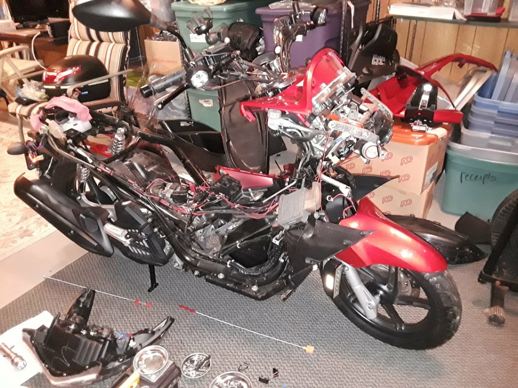

I have a question for you Mel46. To take the front light assembly out, do I need to remove any of the centre console or side panels? Or is it just the visor and chrome plastic and then you can remove the light assembly complete?
And yes, those lights pretty goddam awful. The bottom left right are only 8W LEDs. Gives you an idea of how poor they are.
Re: Fitting new LED spotlights
Unfortunately you have to take panels off, starting from the back, all the way to and including the center "T" cover and the covers over the ignition and the glove box. Then you have to take at least one of the front side panels loose. The bolts that hold the headlight assembly on can only be accessed from the back of it.
Don't worry, with a little patience you can do it. There is a page in the service manual that tells you the order in which each panel comes off. In fact, the entire service manual refers back to pages relating to what needs to be removed in order to get to various sections or parts. If you don't have a service manual, get one or pm me. I will help you as best I can. I have taken mine apart quite a few times now.
Here is a picture of the last time I took it apart...or maybe it was the time before. In any case, keep track of what screws and bolts go to what area. I do this by having 6 or 7 magnetic bowls, one for each area. You could just use Styrofoam and mark each area on it, sticking the screws and bolts face down into it as you go.
Don't be afraid. You CAN DO IT. Patience is the key.
My bike torn down.jpg (364.52 KiB) Viewed 6840 times
