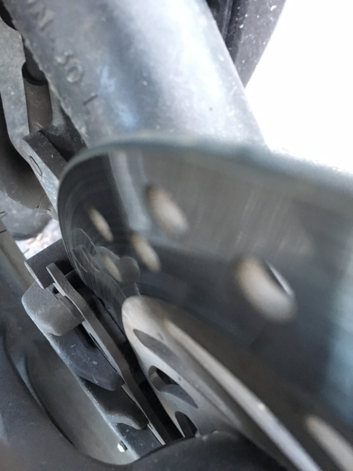

Can't tell if I'm due for replacement yet or not. Look like pad may be getting a bit thin. Also how do I tell when the drum needs replaced? Mileage is 5500 btw. No idea if brakes have ever been done on the bike.

Plenty of pad left

You will replace rear brake shoes many times before you ever need to worry about the drum (which is part of the entire alloy wheel).
Front brake pads can get down pretty close to the metal assuming they are wearing evenly. So just watch for them to have couple of millimeters of material before metal to metal contact. Yours look almost new.
