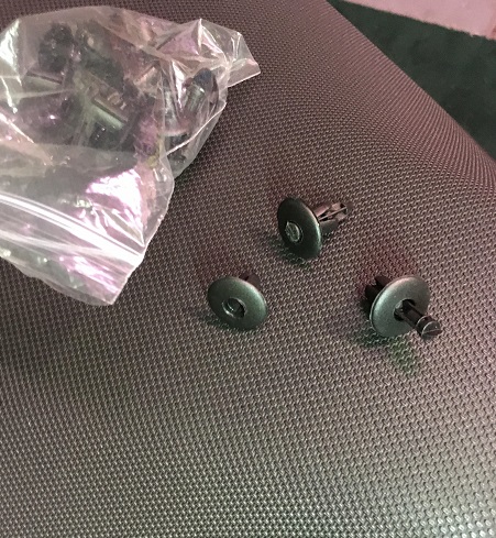

Mel46 wrote:Well that Sucks! They took one of the simplest parts to remove from the pcx and turned it into another impossible to remove plastic pig piece!
brrit your LED PCX is riddled with these trim clips where as your pre-15 models have none so you are not familiar or you would have thought this one out yourself. Drill the hole the proper size and pop one in for now... done!

Or...instead of using a trim clip that homie mentioned above,
You can use a plastic hole plug sold at any hardware store. They come in different sizes and a few colors. I've used them for all kinds of applications. Remove your "what's this" item from the scoot's tunnel area then ride it down to Ace hardware or another nearby. Once there you can size up a plastic plug and be done. Before applying it you can choose to dab the plug in a bit of silicone before seating it.
Plug Examples:
http://www.widgetco.com/hole-plugs?gcli ... gK2EPD_BwE
Plug Examples:
