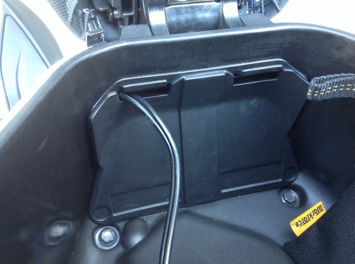

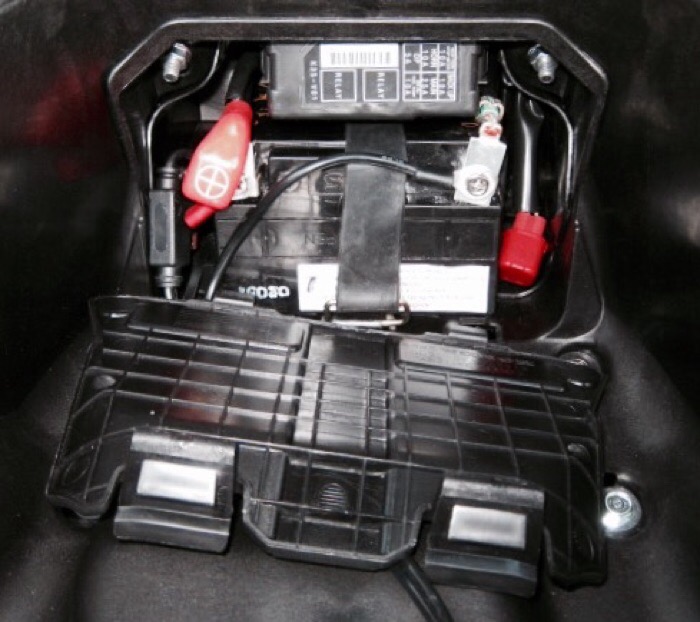

I can help you with one of your questions. I did use the eyelet connector's, they're placed on the batteries + (positive) and - (negative) terminals. You can see a bit of that here:
I then placed that small wire through an opening in the top left of the batteries cover. That makes it easily accessible under my seat.
In my case, I did have to buy the optional extension wire because my electrical outlet is a distance away. That longer extension connects directly into the smaller one and then...Viola! I have Tender Power

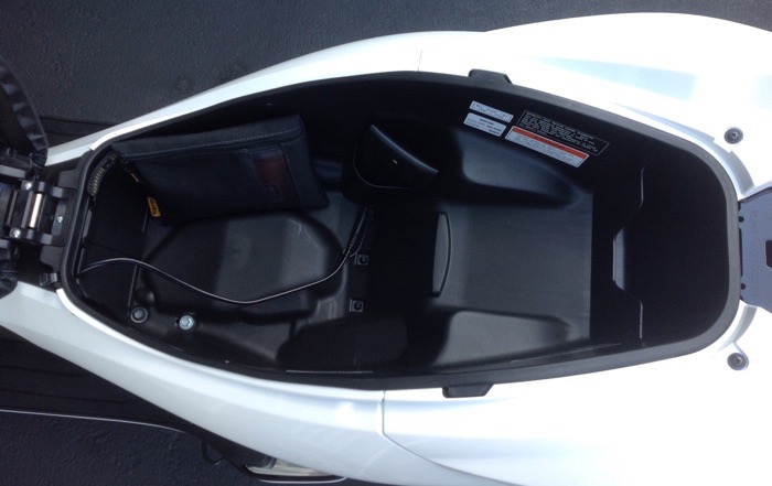

Btw, my seat is closed while my battery is being "tendered." I ran the shorter wire through an open space found on the right side of the seat (near the seats latch). It then hangs outside the bike. This is where my extension wire gets connected.

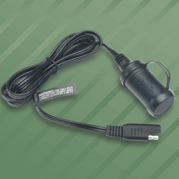

Here are photos of some other bits that connect to the Battery Tender Jr., brought to you by Deltran. Google these items for best pricing as you would Any Item.

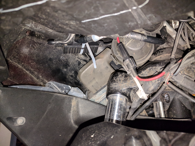

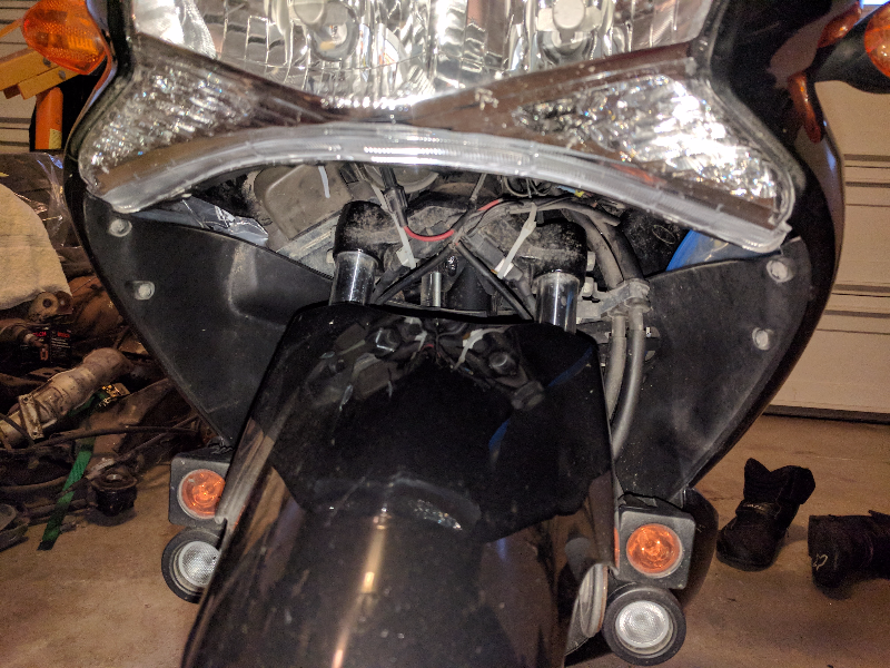

I answered your pm. Just don't freak out when you see my electronics setup. I have an unbelievable amount of stuff connected directly to the battery, for very good reasons. For instance, my add on front spot lights are separate because they pull so much current AND because if the regular lights blow a fuse or have another problem, I can turn on the spot lights and drive home. Then there is my horn. The weak little horn that comes on the bike is pathetic. The wires that run it are not capable of high current, so I use them to run the relay for my Bad Boy air horn.
I also have small strobe lights on the bike for night riding. I can turn them on or off from my handlebar switch.
...and then there is the Battery Tender cable... :-)
So I have a lot going on.
Whitenoise gives you a good example of single wire setups that look good and stay out of the way. There are a lot of accessories for the Battery Tender because of its great quick disconnect setup.
