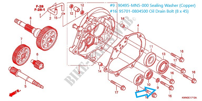

Hello everyone.
I know that some you suggest it's not necessary to replace washers, but I want to.
I just am not sure about it's OEM code.
I usually check this website for OEM codes:
https://www.bike-parts-honda.com/honda- ... 10/1/15469
https://www.bike-parts-honda.com/honda- ... 21/1/15469
So is it
Number 9: WASHER, SEALING 8MM 90495-MN5-000
or
Number 19: OIL SEAL, 26X45X6 91202-KWN-901
and
Number 20: OIL SEAL, 20X21X6 91203-KWN-901
Thanks in advance ;)

Seriously, you want to. Unnecessarily.
If you want to you do it. Unnecessarily. Source your own washers.
The rest of us have lives.

I will not argue with you since it's your own experience and your own decision.
Sorry to say that no one can persuade me while service manual says otherwise.
Hopefully you are not the only person able to answer my question.

Sealing Washer (Copper): 90495-MN5-000
Oil Check Bolt (8 x 16): 95701-0801600
Oil Drain Bolt (8 x 45): 95701-0804500
