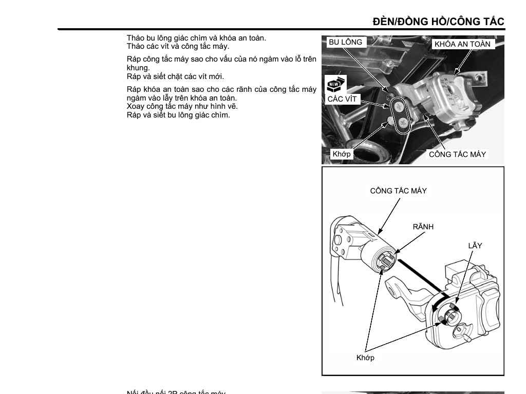

It looks like one the plastics are off its a couple of screws and twist it off the front section of the keyhole. The pdf is in Vietnamese or something.
- ImageUploadedByTapatalkHD1418151539.357688.jpg (111.76 KiB) Viewed 5482 times
