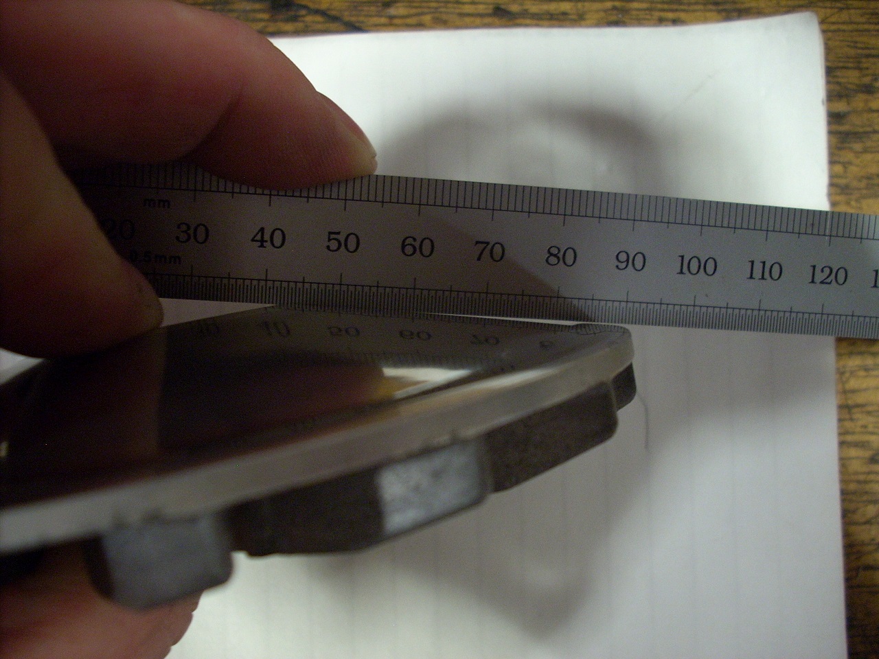

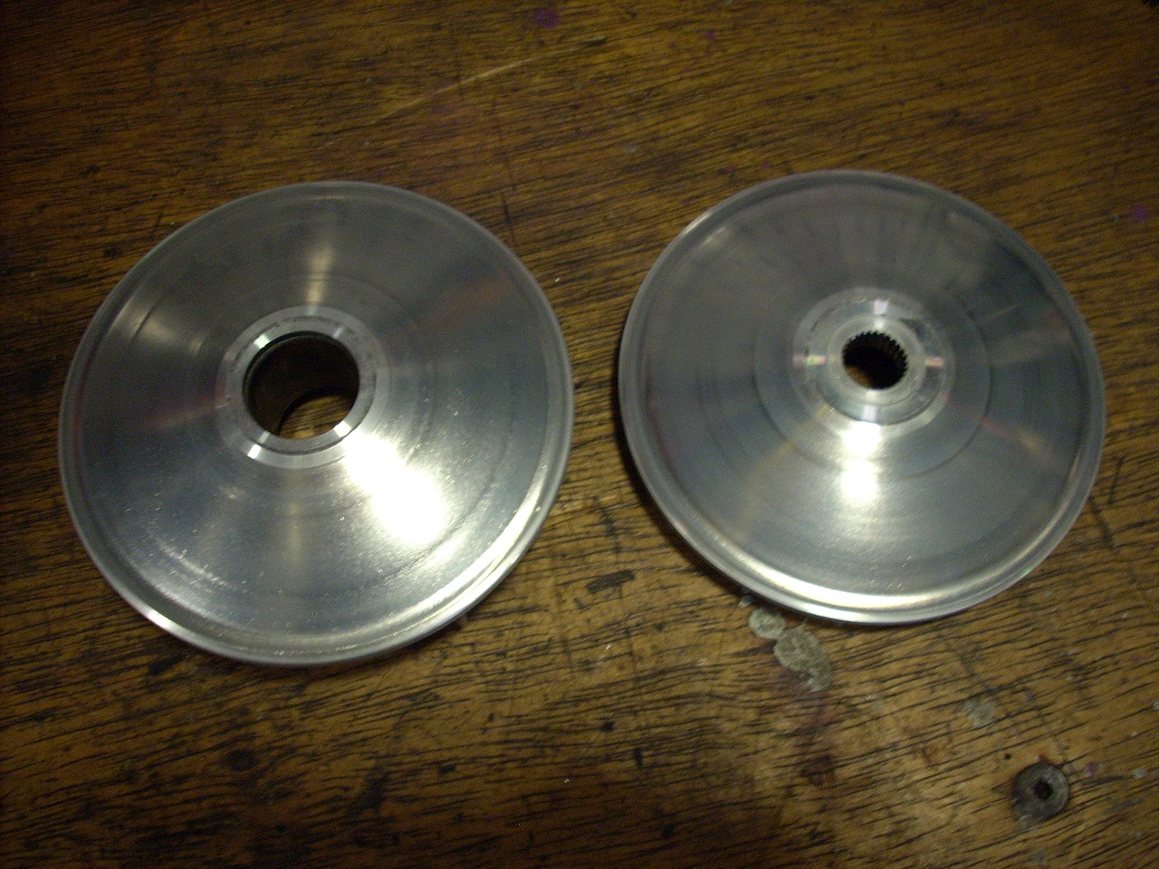

Ok, here's the pics.
On the second you can see the gap under the rule which is more or less parallel until the upturn about 6mm from the outer edge.
This is the same on both faces.
It could be a wear lip I suppose, but after just 9000 miles? The replacement is smooth all the way out to the edge.

It looks worn to me. I'd like to see a new one.

Post by DeaninMilwaukee »
It does appear well worn.
