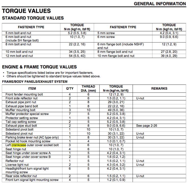

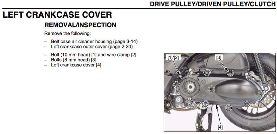

I find the SM unclear on this point. Page 12-4 has no specific torque values on these 11 bolts. Page 12-5 refers to them as "Bolts (8 mm head)," and there seem to be the correct number of the circled in the picture.
Looking back at the general torque values on p. 1-11, I see an entry for "Left crankcase outer cover socket bolt" with a 6 mm thread and a torque value, but there are only 3 of them. In the chart of standard torque values above this, I see two different 6 mm bolt & nut values and yet another for a 6 mm screw.
Comparing with the parts list (cf. link above), I believe that the values we are supposed to use are for the "6 mm flange bolt (include NSHF)" despite the "nut" being built into the scooter.
Yes? No?

There's a plastic cover that bolts onto the crank cover with 3 bolts. It may be them.
