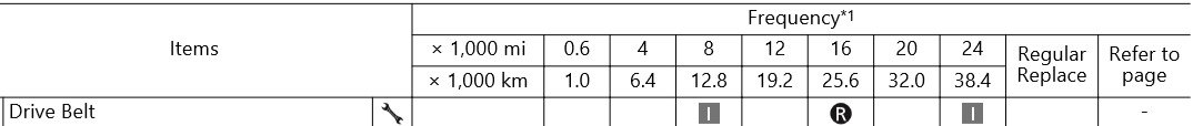

Replace every 24k km according to most PCX manuals. Every 25.6k km for PCX 2019 US.
drive belt PCX 2019 US.jpg (29.79 KiB) Viewed 1678 times
My 2015 PCX is at 15k km. Top speed now is about 110kmh on the dashboard. 2 years ago when it was about 5 months old, it was 114kmh dashboard, but 104kmh on a GPS app on my phone.
I plan to try to replace it myself when the time comes.

raito wrote:Replace every 24k km according to most PCX manuals. Every 25.6k km for PCX 2019 US.
Thanks Raito,
This helps a lot, and puts it into perspective. I’m not planning on riding at top speed the majority of the time, but I need it to be able to when I take my M class exam.
