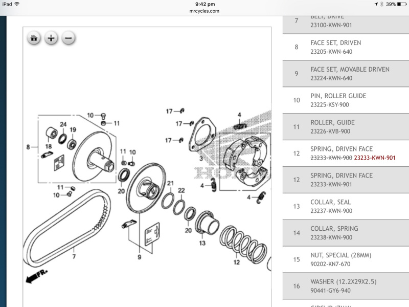

How many miles? The clutch bearing issue raises its ugly head at around 8,000 miles and just gets worse. When we had it changed out on my wife's bike we made it to 10,000 miles and it was really loud.
Honda PCX driven face.jpg (107.89 KiB) Viewed 1135 times
Clutch bearing.jpg (21.67 KiB) Viewed 1135 times
The problem bearings are #18 and #19
Just buy the whole assembly already put together (#8). It is a lot easier to install than the bearings individually.
The above is for my 2013 PCX150, so check the part number against your year.
