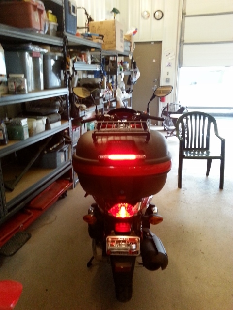

I just installed an LED light strip on my trunk. The strip includes running, brake and turn signals all incorporated in it. There's 5 wires, I was able to purchase a 6 wire waterproof plug, similar to a trailer hook up plug, at a farm store for under $5. I couldn't find anything that would work at any of the chain auto stores. I installed one side of the lead in the brake light area just behind the seat latch. All necessary wires are located in that area. Plus there's enough room to push the lead back into this area to store the wire and plug when the trunk is not installed. I found several rather expensive LED light bars in the $140 range, to pricey for me, but nice lights. The one I settled for was approximately $50 with shipping. It's actually built to attach to a US/Canada license plate bracket, it would be very easy to install on the there, with no need for a plug. I wanted the light higher, more visible, so it's on the trunk.

- The finish product, it works.
- trunk light small.jpg (182.8 KiB) Viewed 2855 times
Re: Led strip lights attach to brake lights
Nice lighting addition! I also see a rack. Did you add that?
Your bike is kept in a very neat clean & organized garage too. Big Like

WhiteNoise wrote:Nice lighting addition! I also see a rack. Did you add that?
Your bike is kept in a very neat clean & organized garage too. Big Like![]()
2yous will either ditto that shortly or speak his mind
I do like a nice garage shot....
Where did you get the rack that is on top of the tailbox? I have been considering putting one on my tailbox for larger items that won't fit inside, such as the replacement tire I recently had to take to a dealer 20 miles away to put on my bike. Because I have so many tail lights on my bike, I didn't want to risk tearing them off when I tied it down. I finally got it tied down with only 1 damaged light. Still, none would have been damaged if I could have placed it directly on top of the box.
The rack is home made, functional, cheap, not very pretty.
