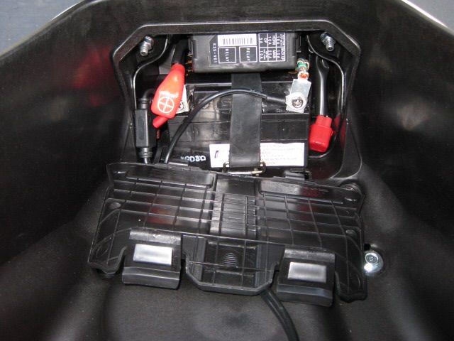

Hmmm, i think you need to take a picture of what you have left. You said the screws have no threads, so i am a little confused. The positive and negative wires should each be attached to a piece of metal with a hole in it. It is easy enough to get to the area around the battery box, if you need to locate lost parts.

Re: I lost the Nut for the Screw to hold in the battery!
(Note: Pay no attention to the wires in the forefront and to the far left. It is an add-on by me, a lead to connect my battery tender). Hope this helps
If you see the two screws that hold in the positive and negative metal plates onto the battery. To conduct the charge. I unscrewed those like you would to take out the battery. I go to place the battery back into the same spot. Now when I go to screw back in the Positive and Negative conductors it wont screw tight. So i might have droped a nut I don't know! lol Very frustrating thank you for the help!WhiteNoise wrote:Welcome to our forums! We need a bit more info. Please try to be more precise. I also have a 2015, so I will share this pic of my battery compartment. Does this help you explain your "missing hardware piece?"

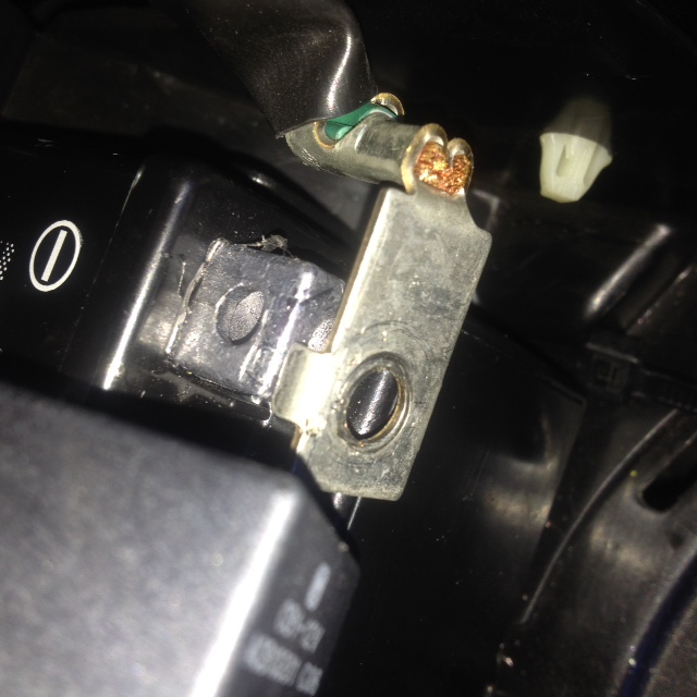

This is what needs to be screwed in. Yet the screw wont tighten due to no threads. Did I Lose nuts?
Mel46 wrote:Hmmm, i think you need to take a picture of what you have left. You said the screws have no threads, so i am a little confused. The positive and negative wires should each be attached to a piece of metal with a hole in it. It is easy enough to get to the area around the battery box, if you need to locate lost parts.
lol just notice I did say that, What I meant was the metal plate which is screwed onto the battery to conduct the charge has no threads.
The square nuts slide into those connectors on the battery. They must have fallen out.
