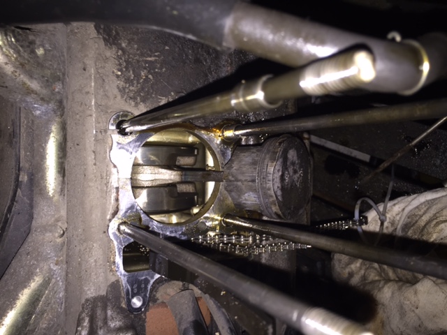

Just to give an update on the engine. I've taken the whole thing apart to reveal the piston and cylinder with pictures attached. The piston doesn't appear to have much movement on the rod and I'm struggling to remove the piston head from the rod - is there an easy way to do this as I'm wary of putting too much pressure on it and snapping the rod.
The piston is obviously in a bad way and the cylinder has some marks on it too. I'm not too sure what the part where the valves are should look like - based on the picture would anyone be able to give me an idea of what the damage looks to be to that area? When I took the bike in originally I was told that you should replace the whole engine in the top and bottom, is there anything in particular that I should be looking for in terms of damage in the bottom end as taking all that apart seems to be a much more complex job!

How many miles was it before your last service, don't normally need a top up between services. Valves look ok for 23K.
Cant tell too much from the photo's, any marks on the cams/bearings. Need to check for movement of con rod/piston.
Doesn't look like its been burning oil to me.

Last service was 16,500 miles, but i changed the oil at 19,000 as they said to change it every 2,500-3,000. I thought that would see me through until the next MOT this month. It's difficult to see much of the bottom end through the gap, but from what I can see there don't appear to be any marks on any of the components. It looks like there is oil when you look straight down through the gap which seems odd.
The connecting rod gives a little movement from side to side which is normal I think. The piston though is quite tough to spin on the rod and I'm finding it hard to get it off/push the pin through. I've attached a picture of the area that I mean.
Which parts are the cams? And what do you mean by it doesn't look like it has been burning oil?
