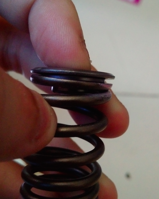

5/ Did you buy the double springs set from Yuminashi too? I bought the one that comes with retainers and somehow I feel like the retainers don't fit into the spring body. Like when you push the retainer into the spring, it should click and the 2 parts come together. The retainers that come with my set is very big compared to the inner spring body and I can't push it in to fit snuggly. like in this picture.

I have bought a set with the 150 head, big bore (I just deciphered that they use light bore 164 for low- big bore 164 for high compression sets) piston and copper gasket set together with the dual springs - as I already had a 164cc cylinder which was used with the 125 head. Guess what - the set cane with the stock springs. So they have sent them separately - I'll comment on them when they arrive.
However as I understand the sonic 125 dual springs and retainers should fit and they are good to until like 12k RPM.

I'm getting Sonic springs right now. Somehow my spring set was faulty as the retainer does not fit the springs so they're sending me another set of retainers for free, but I still want to take a look at that famous Sonic spring set. I got some picture (not mine) of the Sonic springs.
