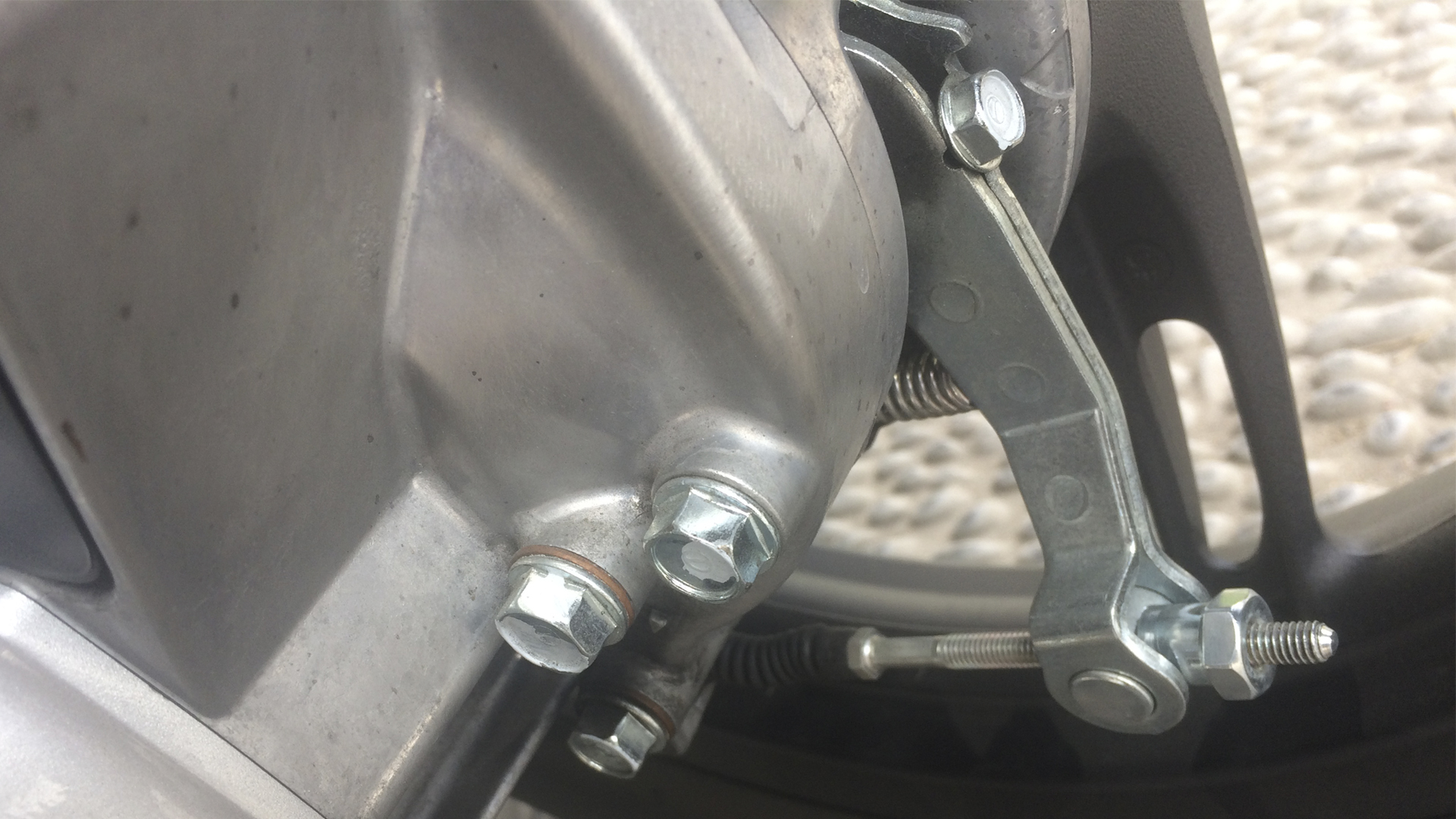

OH and 1 of my rear brake
- tino 5.jpg (990.7 KiB) Viewed 3866 times
