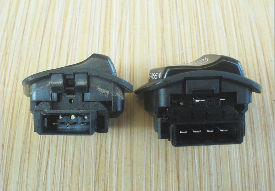

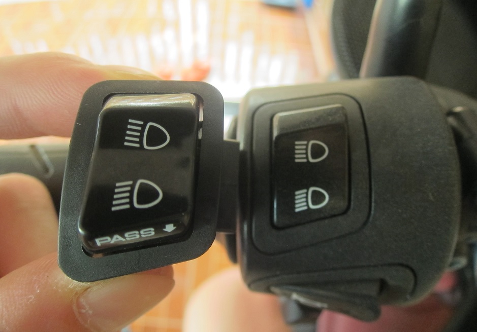

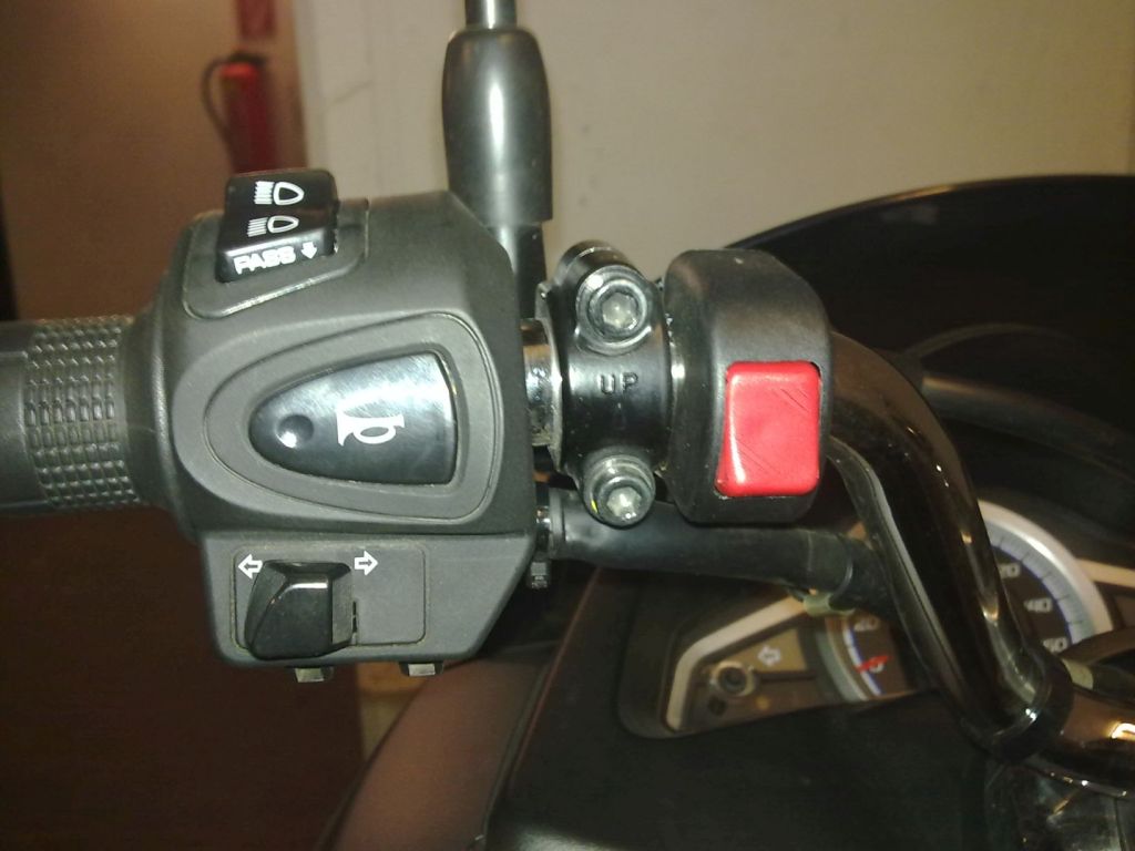

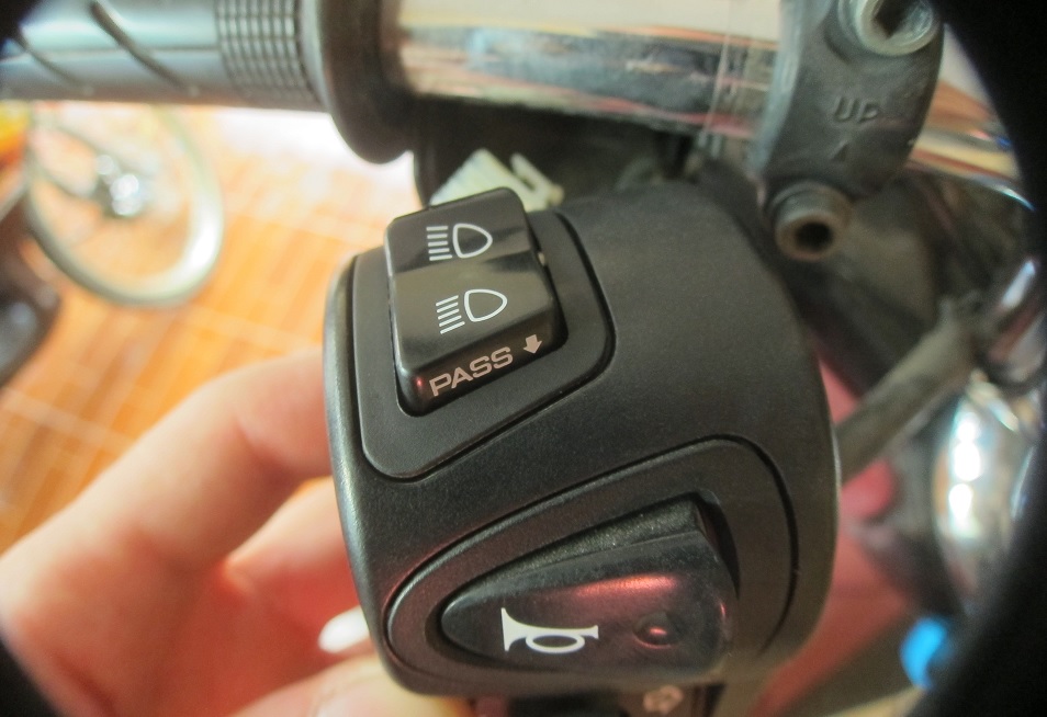

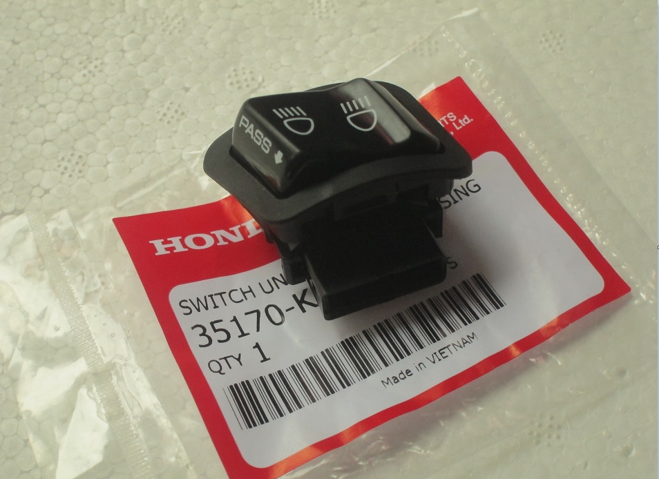

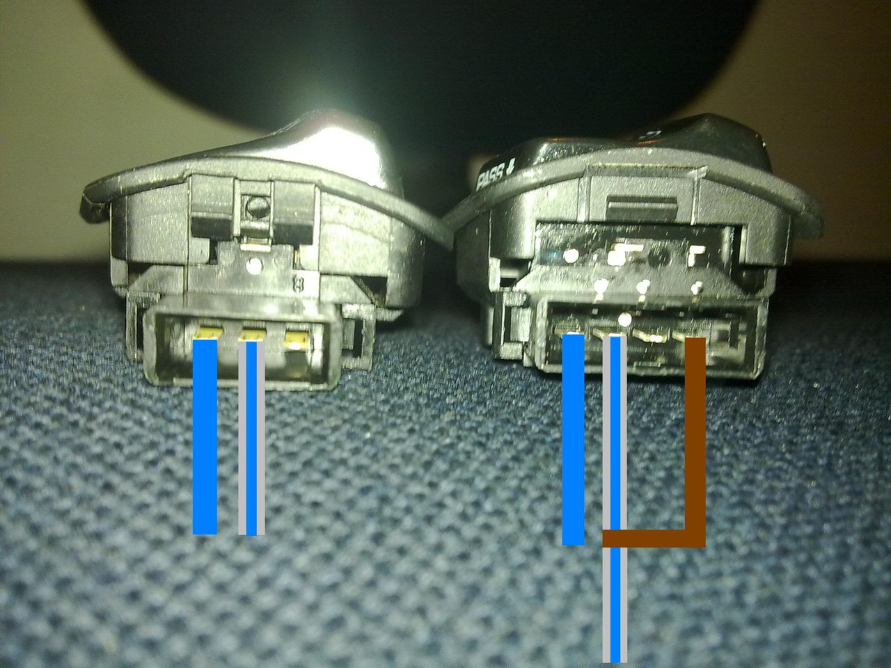

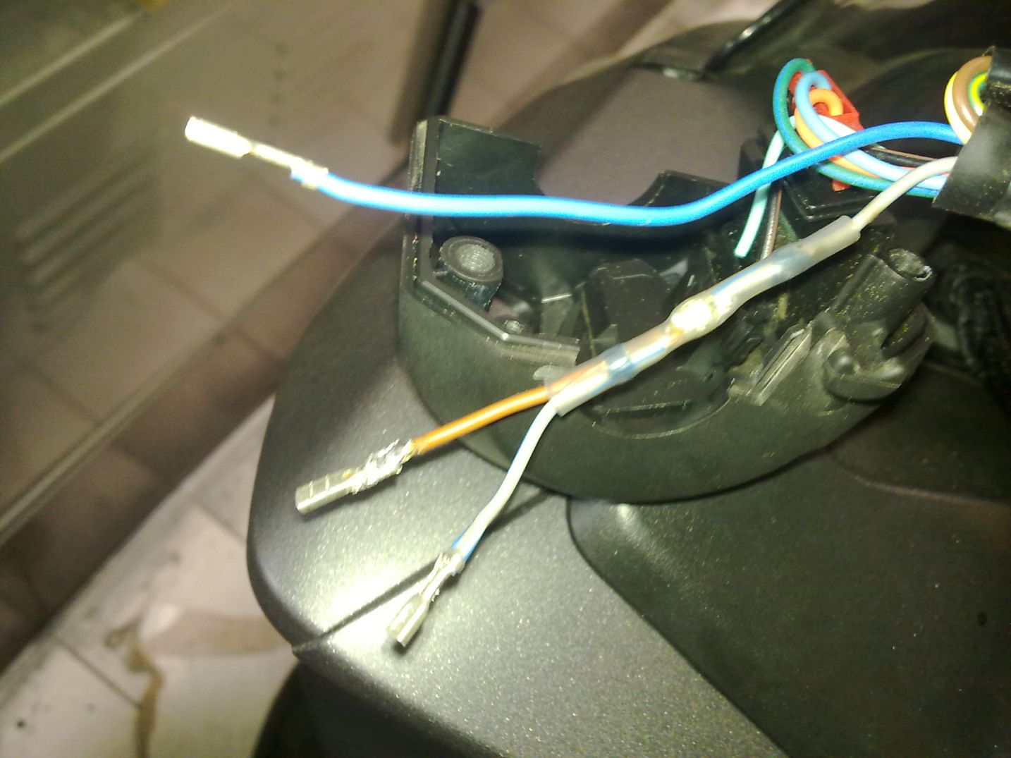

Can buy separately and install with just a little modifications.
I install on my PCX150 2012- works perfect
Part number 35170-K01-902
PCX pass sw.jpg (156.53 KiB) Viewed 5272 times
PCX pass3.jpg (145.54 KiB) Viewed 5272 times
Pcx pass2.jpg (160.5 KiB) Viewed 5272 times
PCX Pass sw1.jpg (129.32 KiB) Viewed 5272 times

That looks like a fun mod, and very cheap at Bikerzbits: https://bikerzbits.com/35170-k01-902.html
