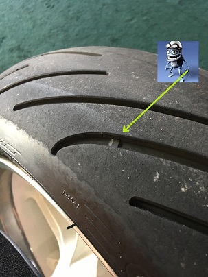

The arrow shows you where the wear indicator is found out on the face of the tire. You must look close for a tiny tread that never rises to the level of the actual tread. If its gone time to buy a new tire.
Also if you wear the center of the tire down it will show a white warning strip around the whole tire before it blows :D Hey some goofs use that as time to buy a new one.

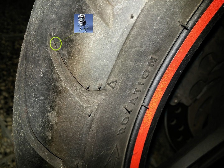

Hey thanks. But I don't see any tiny thread inside
Re: when to change tires?
dpcz wrote:Hey thanks. But I don't see any tiny thread inside
Flashlight Bro... I see yours in the picture and you are good for a long time :D

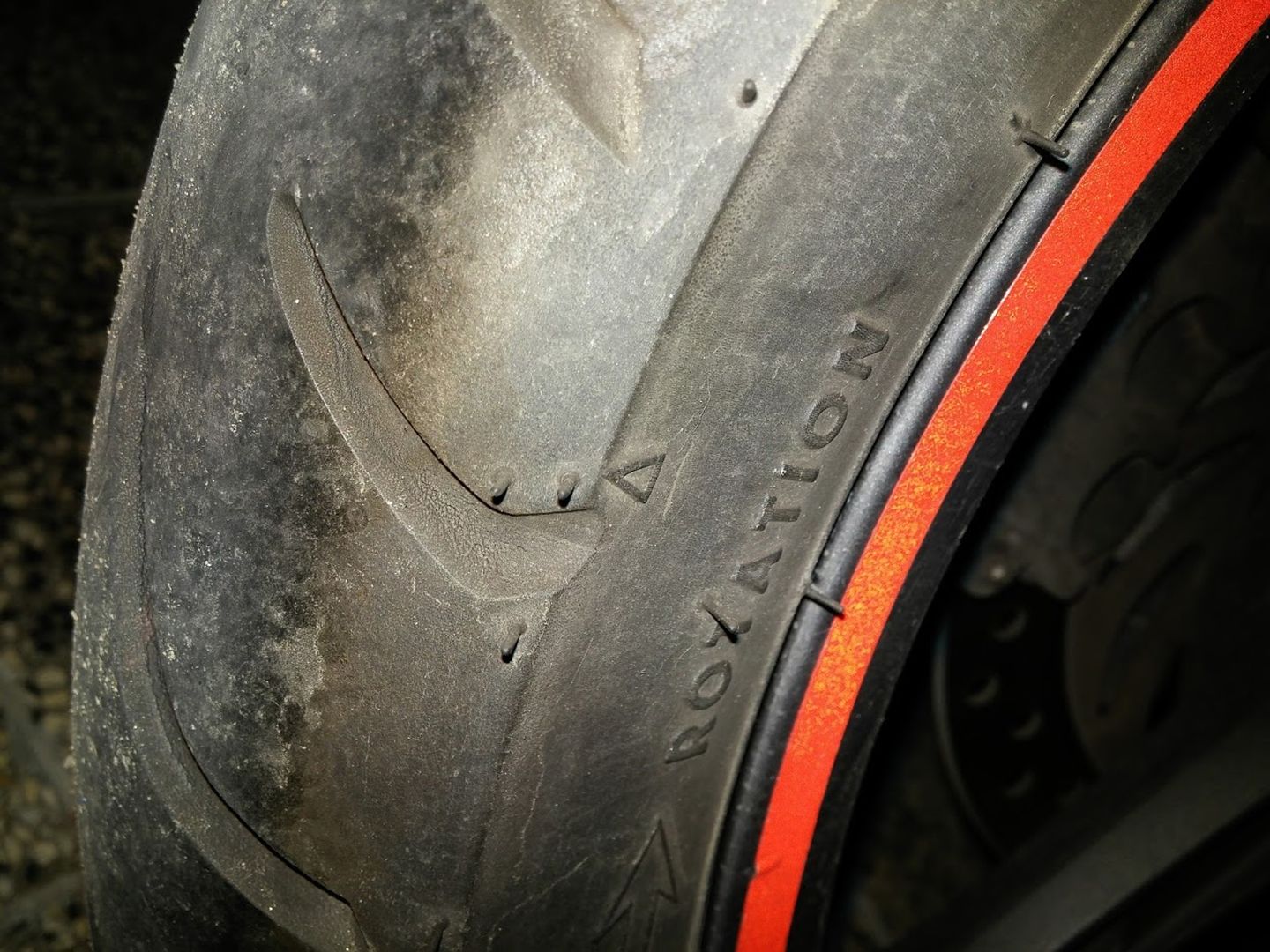

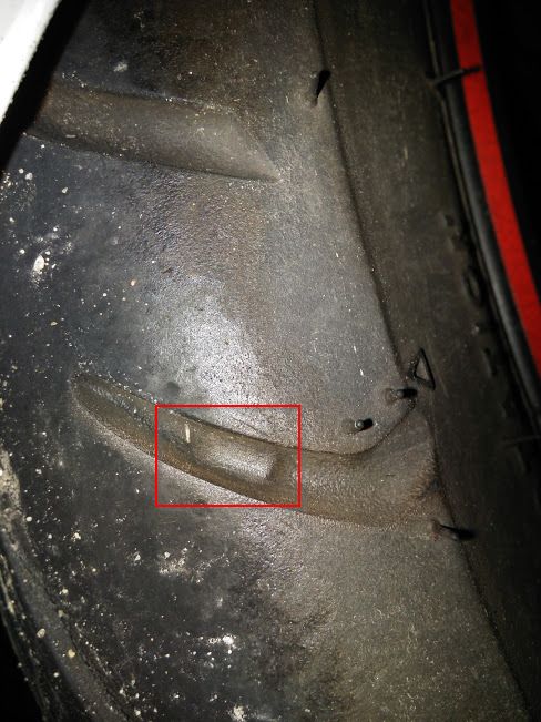

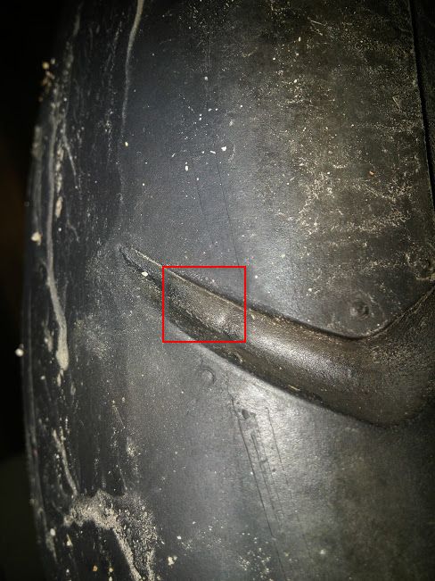

It's very badly visible. It's very flat bump. That means this tires can go forever?
front
front
rear
rear
Um... that is a weird indicator but as you can see you have a lot of rubber to burn off before the bump contacts the ground. So yes, dam near forever on a scooter! BTW what brand tire is that? Take it easy in the rain not much pattern going on there... like a racing slick. Next set of rubber maybe you get some Michelin's.
