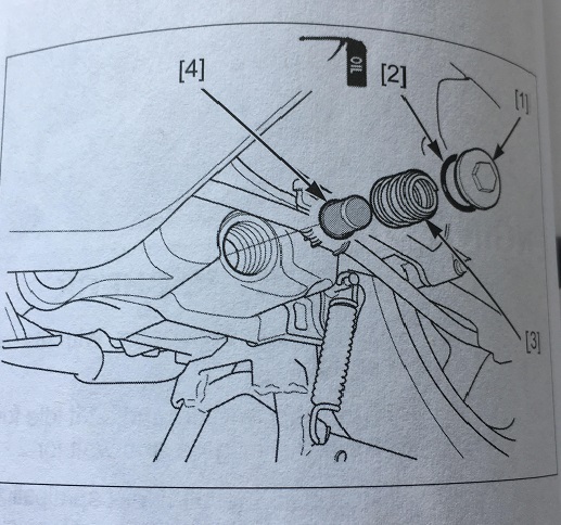

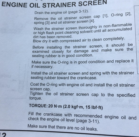

Yes, it's SM procedure. Take time to fit the right socket on that soft aluminum hex. Apparently too many over tighten that back up making it difficult for the next service.

You won't find any sparkling metal chips :lol: But you will find a tiny bit of lint from the factory workers gloves or rags and some very dirty oil which will be cleaner next time ;) Yep, that nut can be soft and shallow, some have ground down the face of a perfectly good socket to insure they get a good bite and move it clean and quick the first turn. The entire kit is available on ebay if you round it off and have to use more aggressive tools. Do not attempt with a crescent wrench :roll: I haven't had an issue with the OEM part as it wasn't tight on a new bike and I didn't over tighten it when I put it back.
