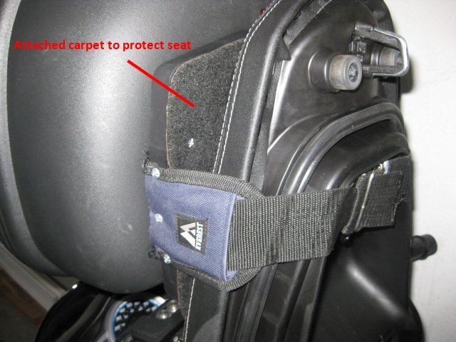

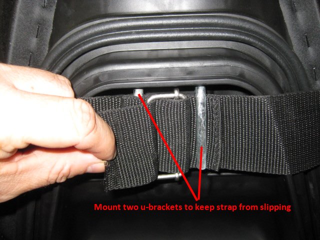

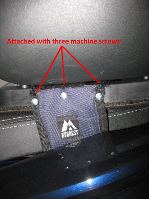

Recently, there was a post in the "PCX Deal of the Day"
It showed a top box mounted on the back of the seat.
I was very interested in the mounting, and I contacted the seller of the scooter.
I will be buying the top box next month and have extra storage on my rides.
He was VERY helpful and provided the following information.
"I used a carpet floor mat and mounted it to the bottom of the trunk mount plate to protect the seat. Then I mounted two u-brackets under the seat to keep the strap from sliding back when accelerating or stopping. Then I used a duffle bag shoulder strap and cut the pad in the middle and mounted each end on each side of the mounting plate using six machine screws. This method works really well for I can just undo the strap and remove the trunk with no damage to the seat. Hope this helps."
Here is the link to the top box:
https://www.walmart.com/ip/Yescom-30L-M ... /678308450
He also sent the following photos to show how it is set up. This is his PCX, not mine, but I look forward to having the extra storage next month!!

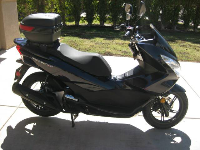

Re: Seat mounted Top Box
So all these pics and no pic of it mounted on bike?
Please post one, nice mod.....
I added one of the photos from his craigslist post to the original post here. . . Look Up!! LOL!!!Jge64 wrote:So all these pics and no pic of it mounted on bike?

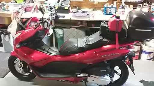

Interesting Mod, but what needs to be done to take it off in order to lift the seat and access the under-seat storage compartment?
On my bike, it takes me only a minute to access the underseat storage. Take the gas container off by undoing the bungee cord. Then I release the red connectors by way of releaseable tie wraps. Then the back rest slides forward one inch as you are lifting the seat. Simple. However, since groceries do fit in the bucket and if I don't have the gas container I can put a bag in that slot, I usually don't need to raise the seat...but I can if I need to.
As far as that bucket that is installed on the seat itself, to me it looks like it had better be empty or close to it before you try to lift the seat, or you could put too much pressure on the hinge.

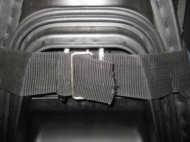

That is my bike. Here is a picture with the seat open. One thing I needed to add. The strap goes completely around the truck mounting plate (between the trunk and the top of the mounting plate). The screws hold the duffle bag pad and strap in place.
I haven't noticed any stress on the hinge, course I don't have twenty pounds of gear in it when I lift the seat.

Thanks for the extra photos!!knoll wrote:That is my bike. Here is a picture with the seat open. One thing I needed to add. The strap goes completely around the truck mounting plate (between the trunk and the top of the mounting plate). The screws hold the duffle bag pad and strap in place.
Another thing I like is that it looks like you can just press the latch and remove the trunk quite easily.
So, even if there is a moderate amount in the trunk, it looks like it will be easy to remove.
So, if I go shopping I won't have to carry the bags to the house, I can easily just take the whole trunk, right?
Please correct me if I'm wrong.
