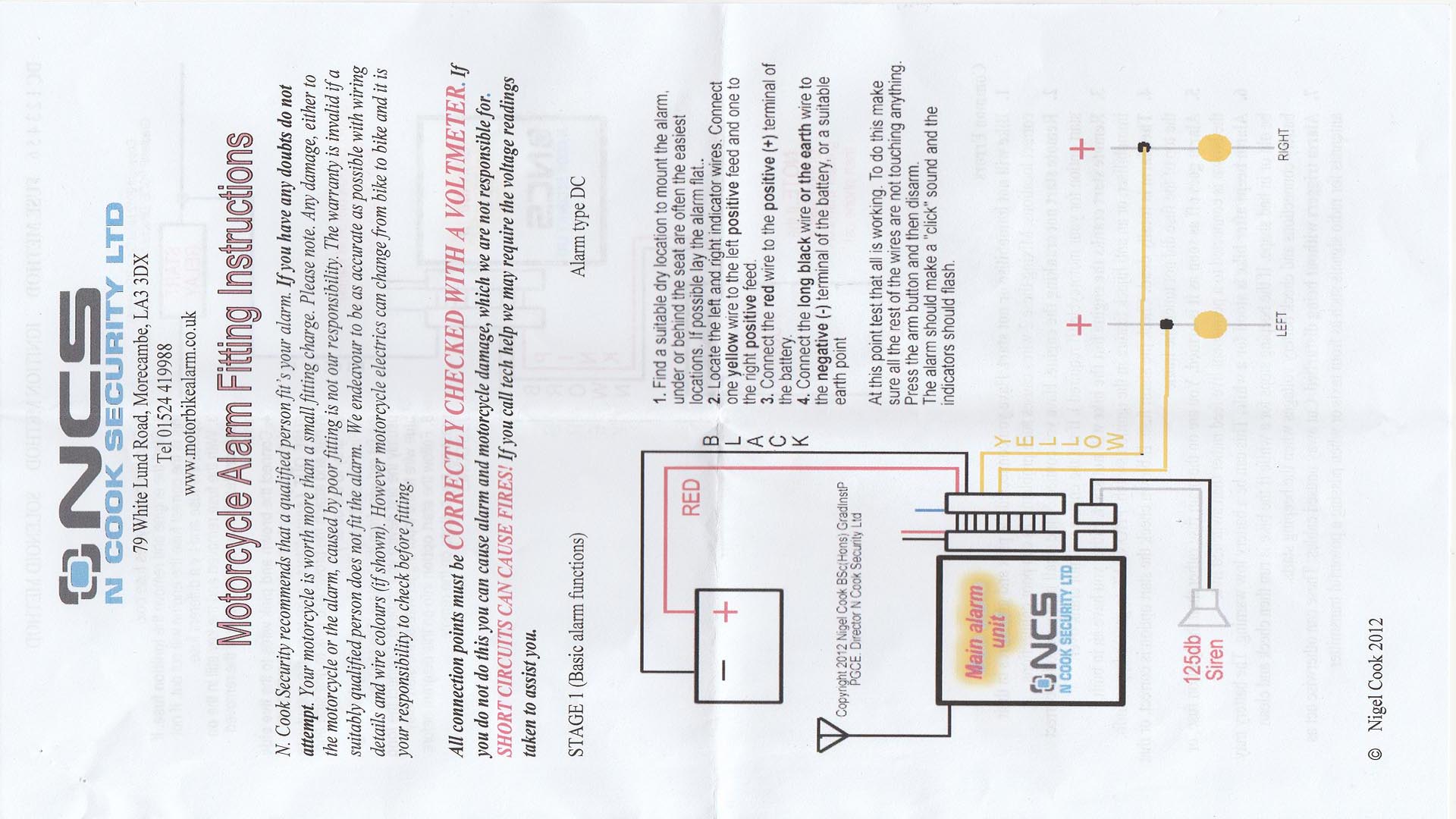

Hi there everyone, I think I looked everywhere without any luck for a guide to how to install a spy 5000 alarm system on a Honda PCX. So I thought I will ask if anyone knows a good guide how to fit this alarm system. I will be really, really grateful!
Everywhere I look I see people playing around with the remote but not actually showing how the installed it in a Honda PCX, it gets frustrating when you go on YouTube and all you see is that lol.
Please can you post images of your alarm system that you installed, where you installed it and how you open it up and looked for the wires.
Thank you guys. I really appreciate your help in advance. Thank you again!

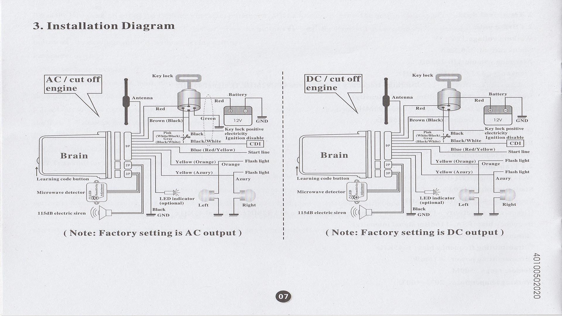

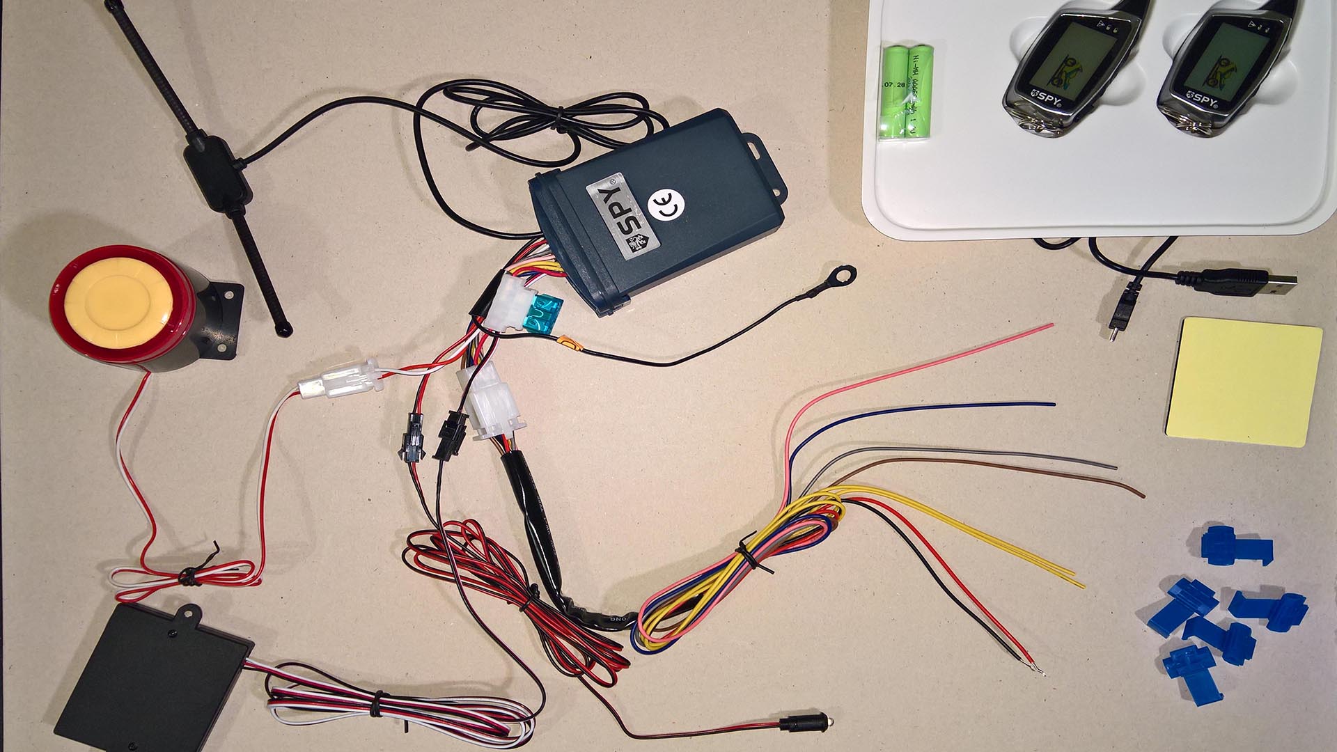

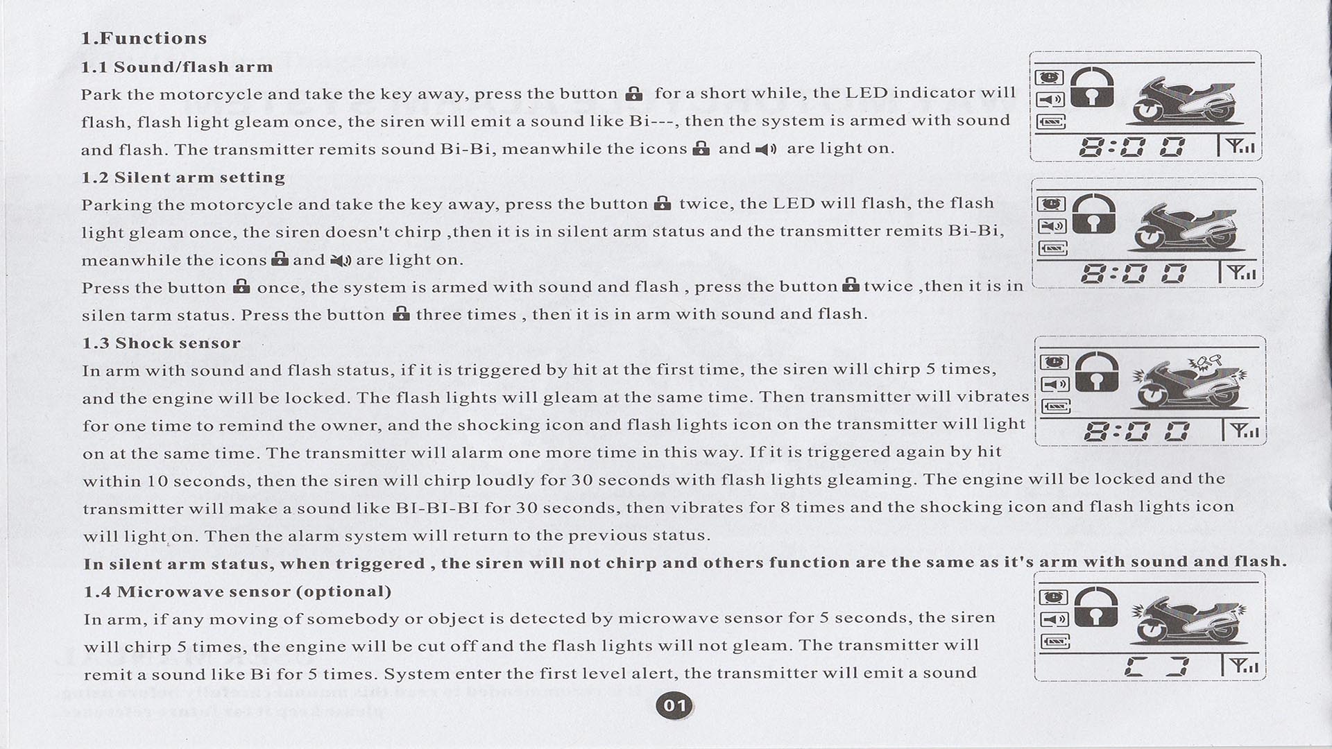

I understand the the other links are for different motorcycles, they had different configurations and wire types configuration. if it's possible if anyone can guide me on the Honda PCX configuration for example, where to install them, at the front where the windshield is or underneath the seat ETC.
It doesn't have to be this particular alarm system on a Honda PCX, I believe most of the alarm system have the same type of wiring far as I seen in different type of blogs and YouTube videos. if someone has an alarm system on their PCX can post some images of the way they attached and assembled the alarm system on their PCX that be much appreciated.
This is what I bought the link is: https://www.ebay.co.uk/itm/SPY-MOTORBIK ... 2749.l2649
This is the alarm system that I received.

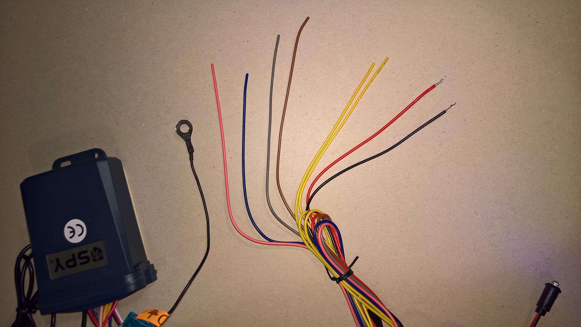

These are the 9 wires that needs to be connected.
This is the manual that I received with the product.

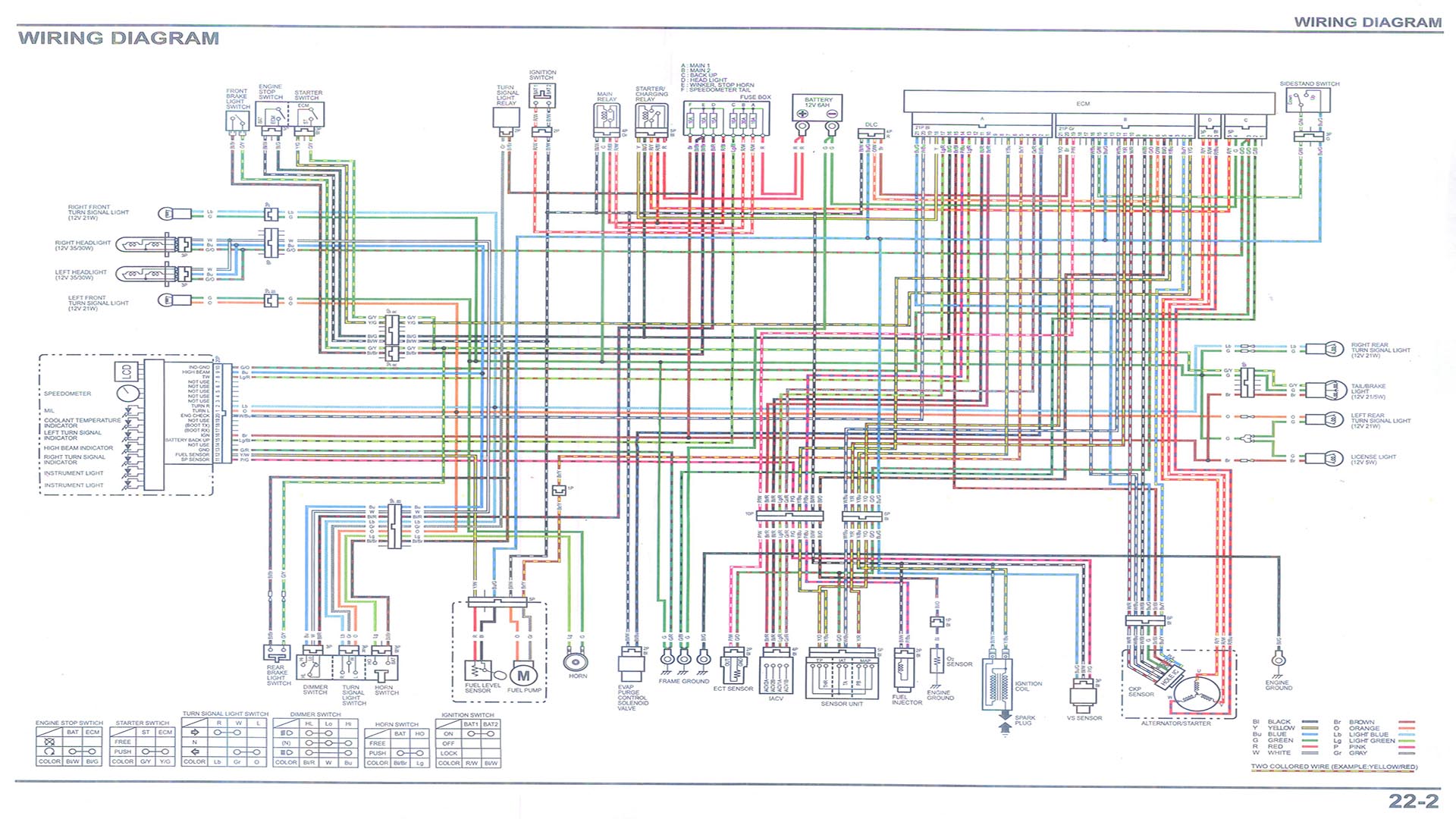

This is a Honda PCX wiring diagram that I found on another post on this website: http://www.hondapcx.org/viewtopic.php?f=15&t=771
Honda PCX150 Wiring Diagram.jpg (320.23 KiB) Viewed 9700 times
Thank you for contributing in advance and helping me out. Thanks again.

That looks like the same vendor I googled earlier, they claim that they have bike specific diagrams and tech help... I'd take advantage of that and ask them for whatever they have.
